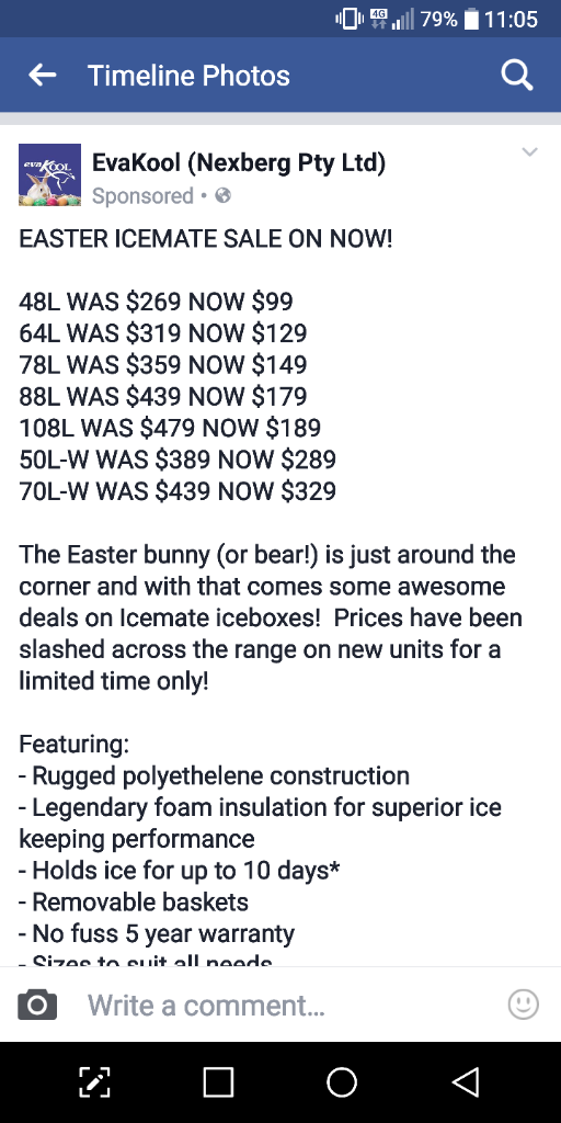

    Anyone looking for a cheap ice box?
    http://www.evakool.com/iceboxes/icem...elene-iceboxes
