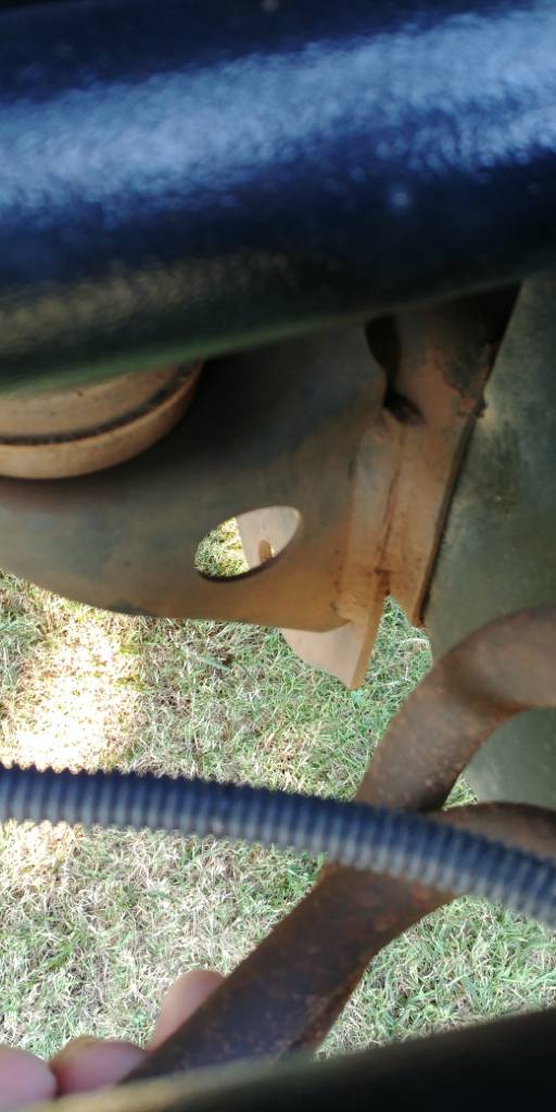

    I picked up the bar today. Has anybody put one of these on lately? The body mount bracket is in the way. The weld looks dodgy as so would I be right in saying this is not a nissan weld? Do you have to grind it level with the chassis rail?Chassis rail.jpg
    It doesn't look the best. This is mine
    Thanks Clunk, dodgy as shit but may not be an issue yet. I started a new thread as I thought the original title may miss target expertise I am looking for. I have posted new pictures but worried if I try and bend these out it may crack welds.http://www.nissanpatrol.com.au/forum...-fit-Need-help
