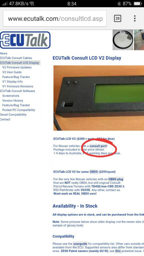

    you can plug in my ECU-talk if you want and delete any errors ??
    Thanks John.
    Yours won't suit my plug.
    Found this last night.
    Didn't know that there's one to suit.
    Might have to invest in one.

  6. #15
    31,635
    @Roofy suits Bobs
    that one you showed is the same as mine,
    cant see why it wouldnt suit

    @Roofy suits Bobs
    Different plug connection. My is consult port yours would be obd.

    Thanks Bob, is yours a consult port grey 14 pin?
  13. #20
    Patrol God Bob's Avatar
    Oct 2010
    Pakenham
    6,341
    3,979
    47 Post(s)
    Yes it is
