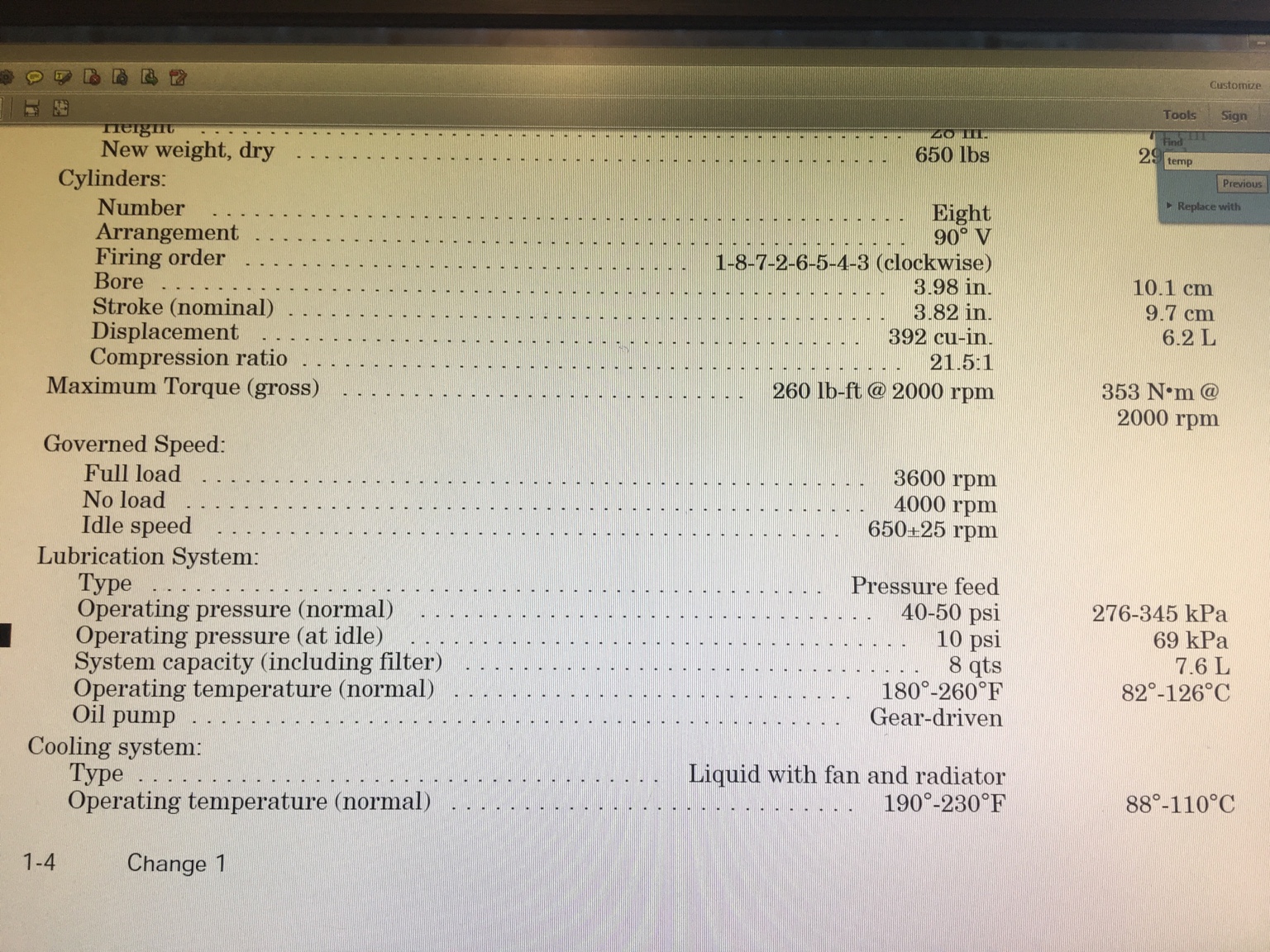

    Cheers Phil, just meant that the US military apparently want their 6.5s running at a minimum of 88D op temp and others are suggesting lower thermostats. The yank forum sites I was researching earlier on did seem to consensus GM owned 88D thermostats also.
    MB, I checked the specs on the thermostat i have from BD as a spare and its a 82degC unit. Sorry, this has been bugging me! And it matches the unit i got on ebay, which was an AC DELCO. BD stock tridon, part number TT2000-180 Hi Flow
  4. #564
    G'day Phil, I'm by no means an expert on these donks sorry mate, just learning my way through them too to make mine hopefully bulletproof. Here is the page photo again from the US military full maintenance download that was posted years ago here.
    ACDelco do make several different TS ranges but the yank forums seemed to recommend the 131-103 88Ds which is what I received.

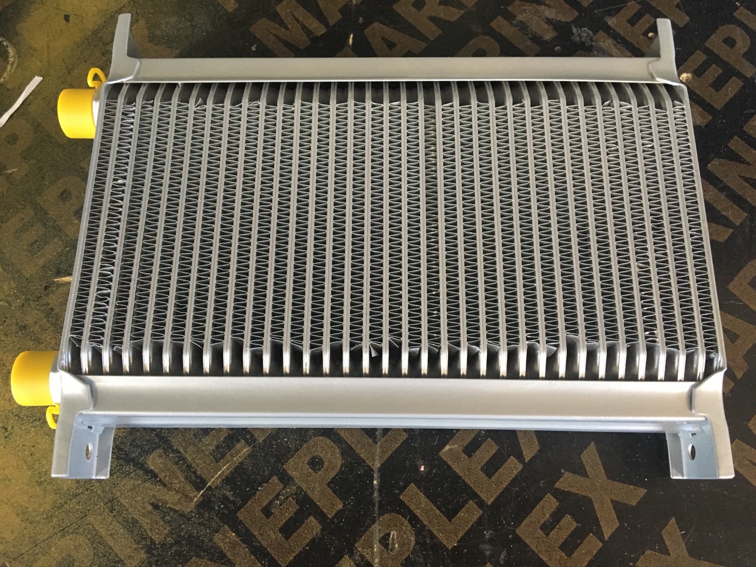

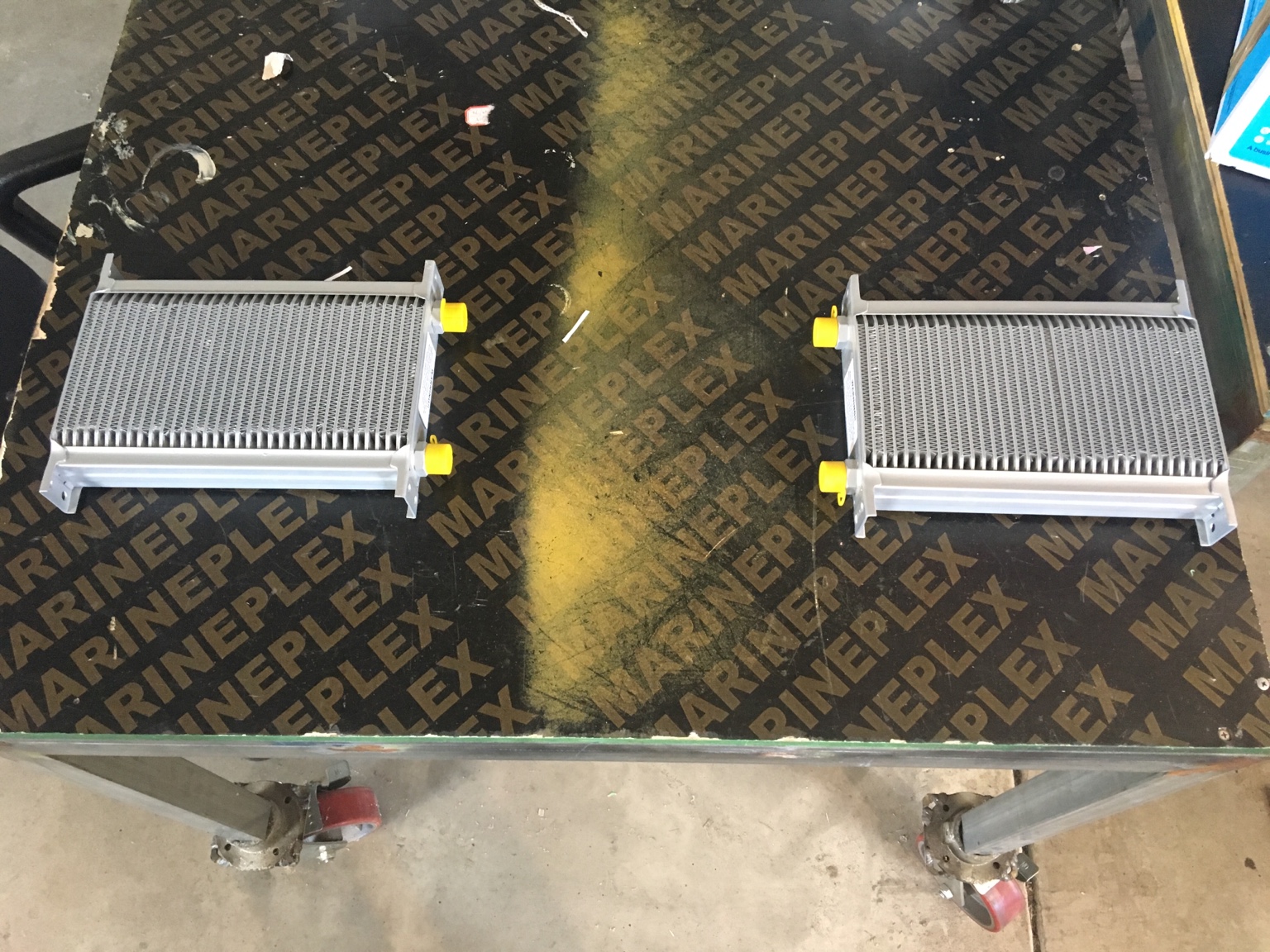

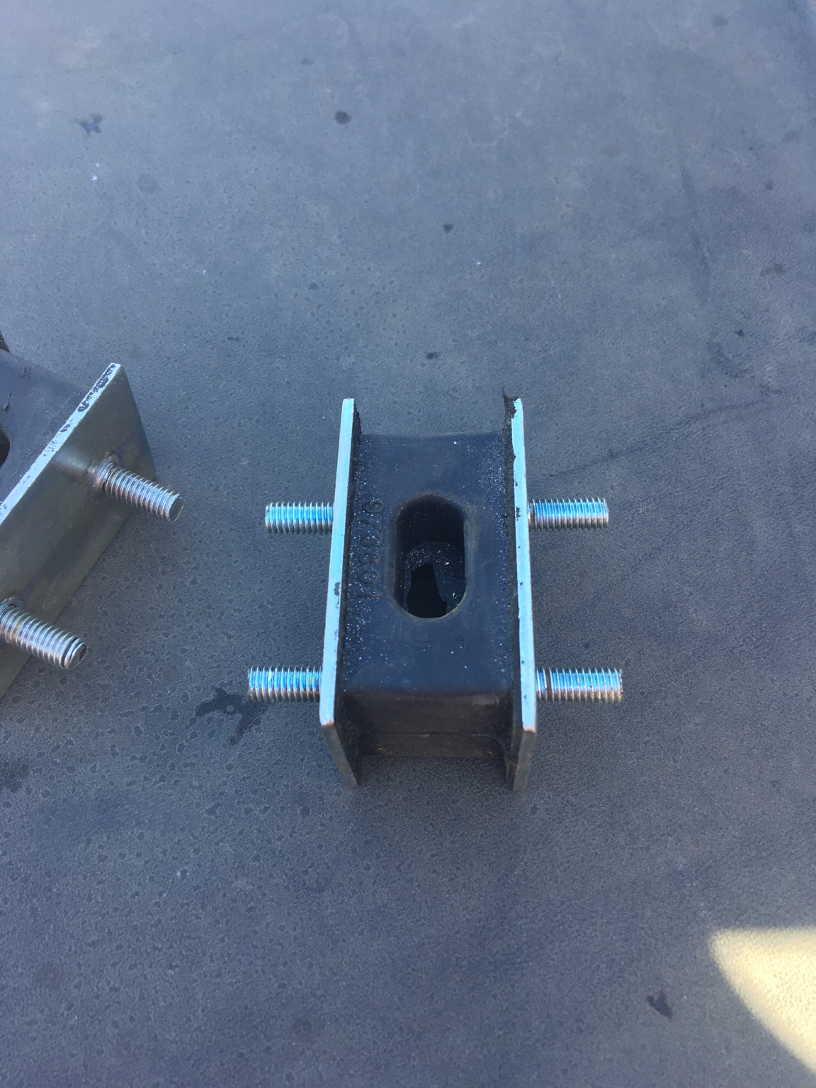

    Oil coolers turned up today. Can't complain about the service from the ebay mob being the only stockists in the country I could find. Ordered Friday delivered Monday! Dropped them off to Mill for final fitting and collected whilst in Mansfield some ISO type small exhaust mounts. 'K&M Onsite Auto Electrics' in Mansfield are great blokes and stock a hell of a lot of gear contrary to their biz name, highly recommended !!
