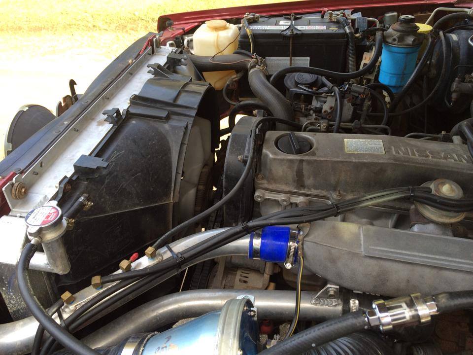

Quote Originally Posted by 89gqpatrol4x4 View Post
Thread dig here sorry mate! To get your cooler back you cut that vertical bonnet catch steel bar off and took off your aircon thermo?
Any negative affects on aircon? And any affects of removing that support?
How's the cooler lasting over the rigures of 4 wding?
Nice work too mate keeps it subtle!
Hey mate ABs away for a few days but have a front mount on my GQ. Yeah removed vertical support just a couple of bolts top & bottom. Didnt notice any difference really maybe bonnet needs a firmer slam to shut but that might just be my catch. Took off the thermos for the aircon too, still works beutiful the only loss will be aircon might not get icy cool if just sitting there idling cos it's not getting airflow but hasn't been an issue at all with mine really. .
