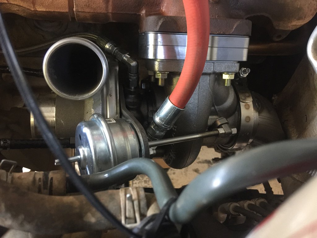

    Just a little drive. I got out a few times to lift the bonnet. A little bit of smoke from stuff burning the crap off.
    Playing with the boost controller to find its range and I think it's about 22psi now. The cut off dump pipe is very close the the clutch line and I gave it a fair go from a rolling start in second and it pulls well. Much more lively than before. Boosting from low it's a bit boggy like the other one but I don't have a pyro and don't know what my EGTs were but when I went to pull up I had no clutch!! I think I just cooked the fluid in the line close to the dump though. A couple of pumps and it was back.
    Called it a day. I'll limp it into the exhaust shop tomorrow before giving it another push.
    I did a U turn and did a standing start. At take off the whole car stands up!!! Not just lifting the front left! All 4 wheels seemed to want to lift!! No shit! Like it was in a crouch then stood on takeoff!
    It's no race car but I think this thing is going to be a towing beast!
    Awesome, no leaks or anything?
    Banjo oil feed ok?

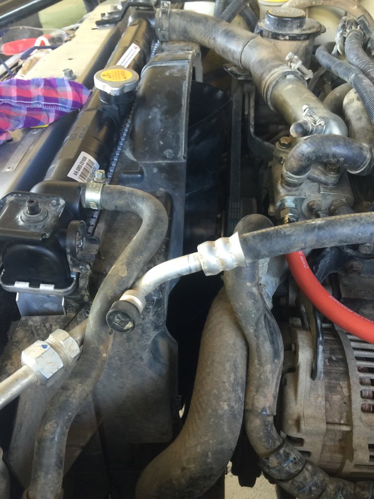

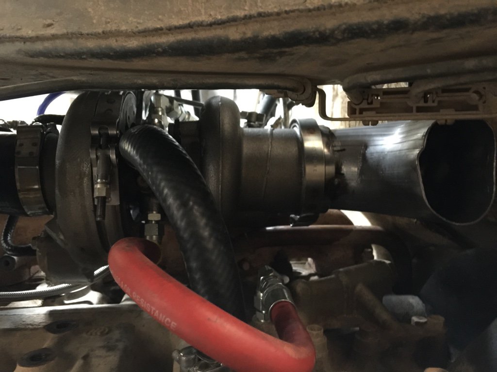

    Turbo Upgrades for the GUIV TD42Ti

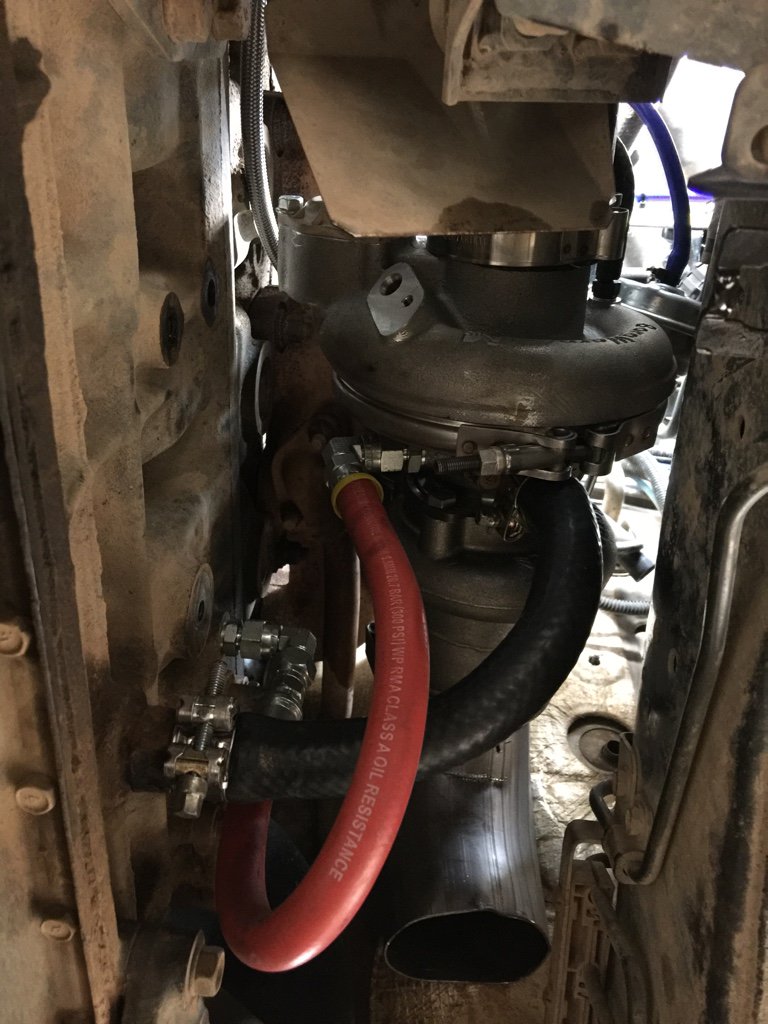

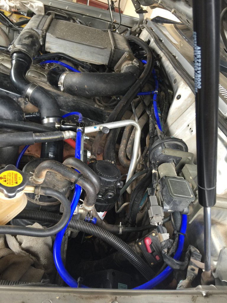

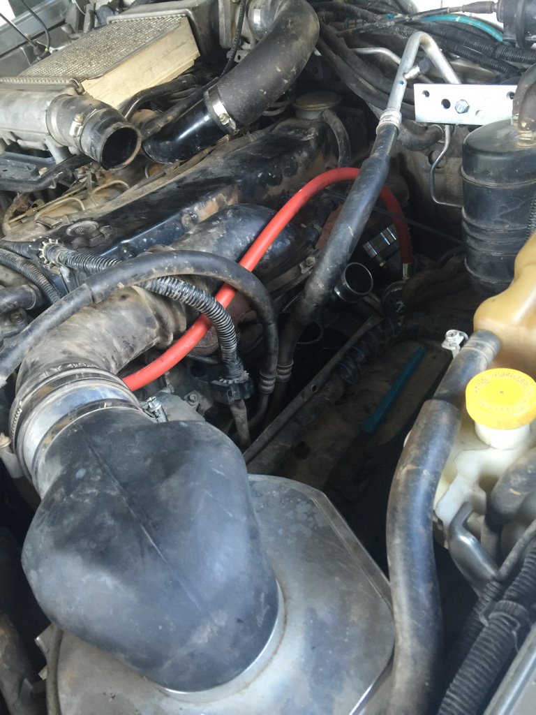

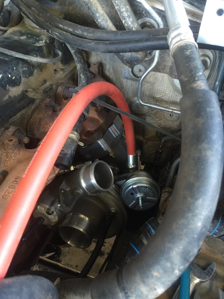

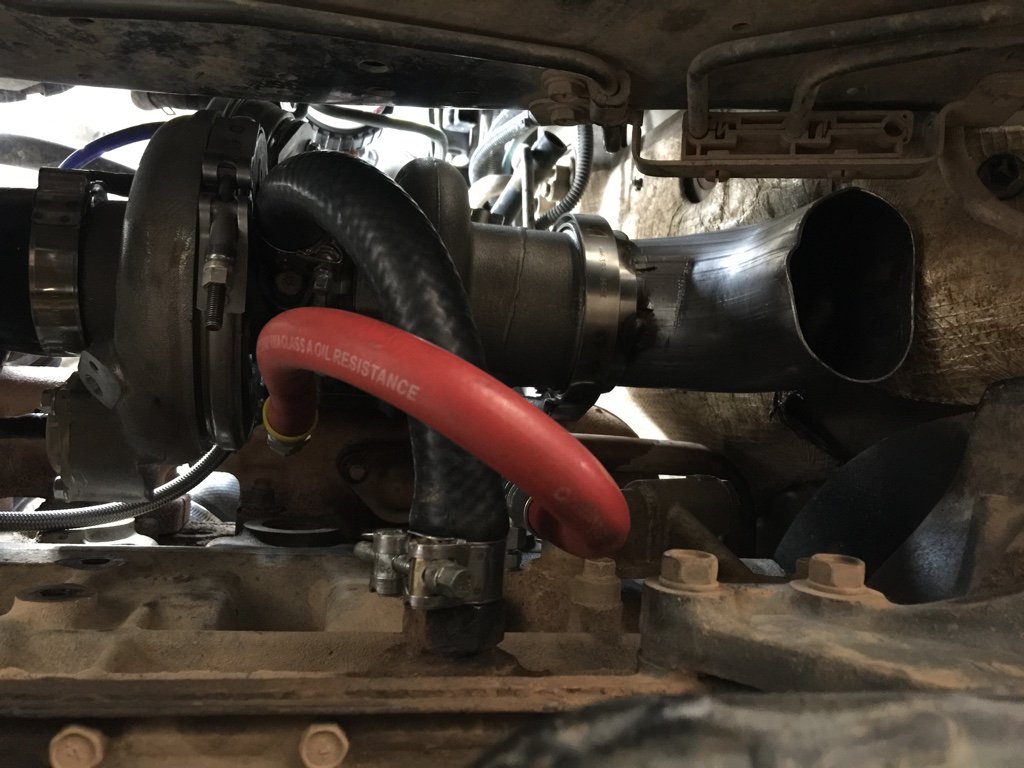

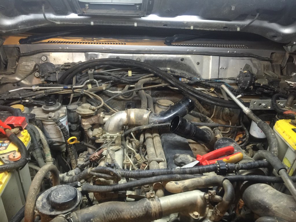

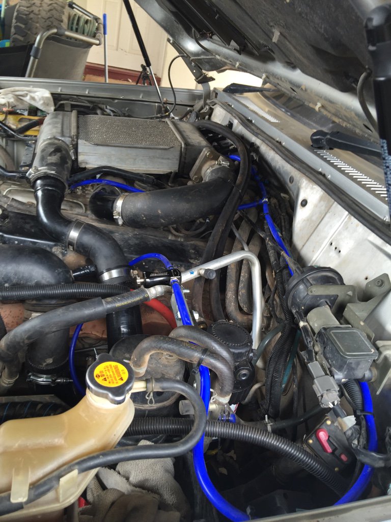

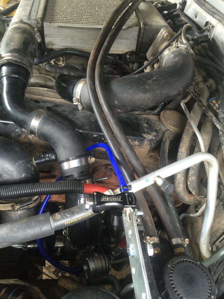

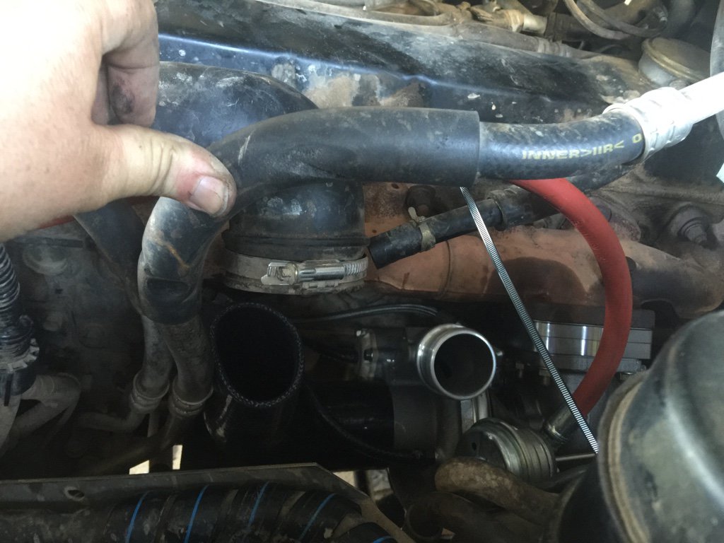

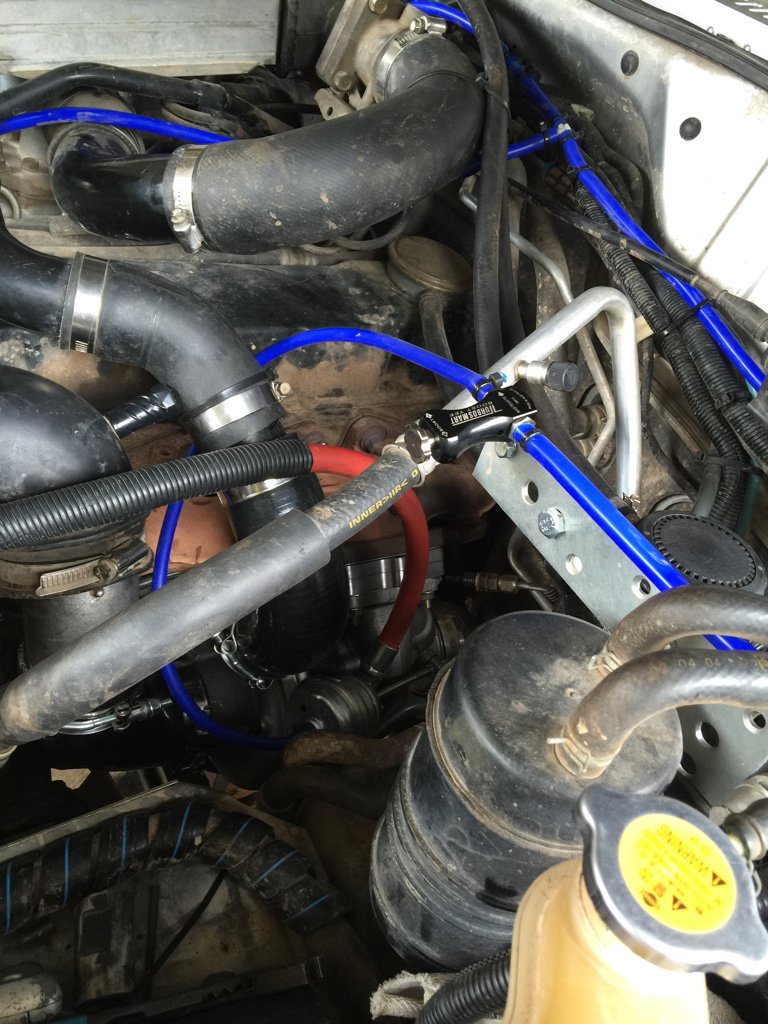

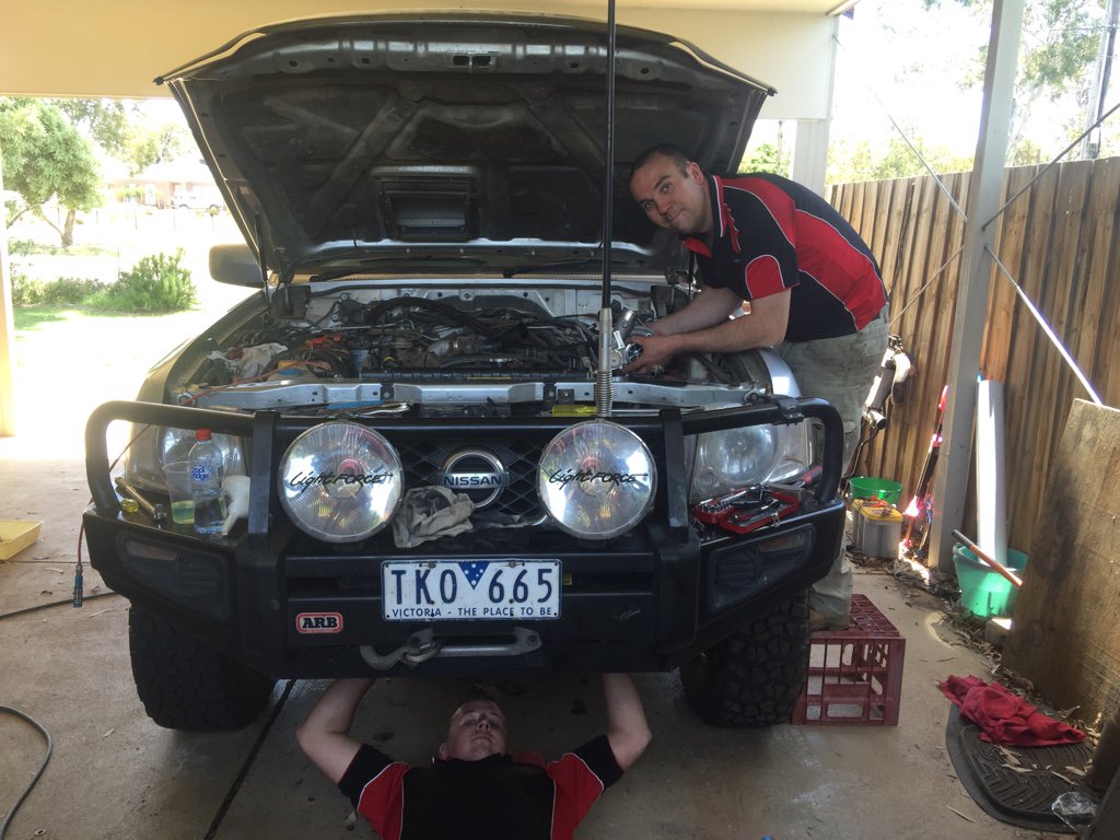

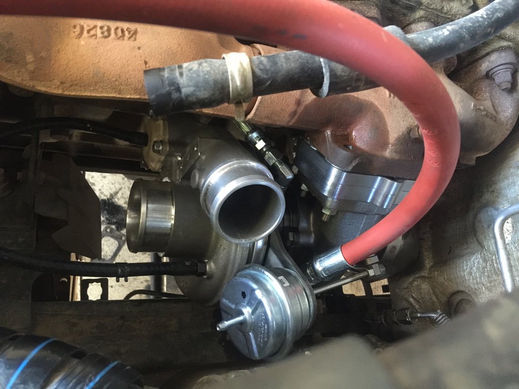

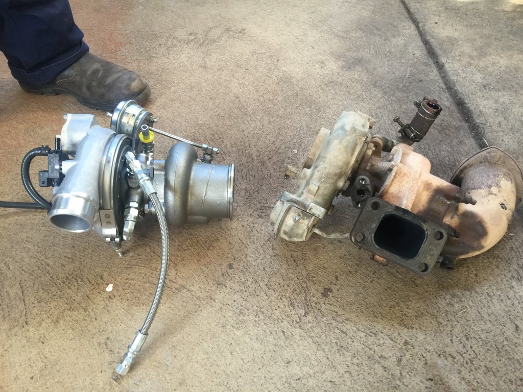

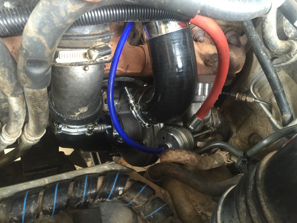

    So it's been a massive weekend. Phone on 1% but I've plugged in to post this.
    Well just inside now. Everything is packed away. The driveway has also had a pressure clean. Got pretty messy so looks great now.
    I'd like to thank AB and Nic for a Stella effort yesterday. Could not have got it done without you chaps. Thank you.
    A Huge thanks also to NissanNewby! Matt, your a wealth of knowledge coupled with patience show to us plebs. Thanks for your guidance and epic photos to my phone. A huge help mate.
    Here is a bit of a photo bomb. Not heaps of pics though gents, we were busy!
    I looked for that 12mm socket for a bloody hour!!! Was going to be a long weekend without the 12mm socket damn it!
    The boys were Awesome!!
    I used some of the old pipe work.
    End of Saturday. 14 hours after 3 hours sleep and 8 hours stripping stuff Friday night !

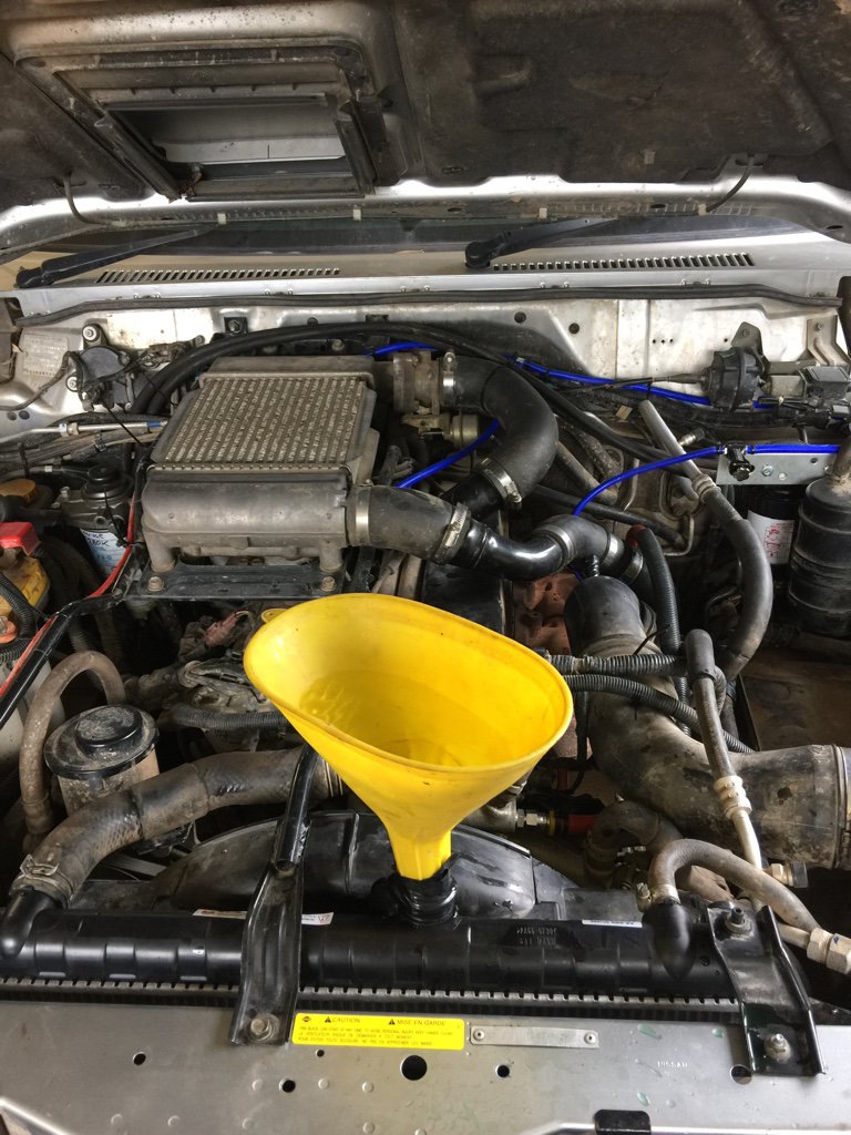

    And today was the finishing touches.
    So I bought premixed coolant and there I was at the end of emptying the first 5lts of coolant into the radiator. I noted it was pretty thick. Slowly going in I read the label upside down and it was bloody concentrate! WTF?? Damn it. Off with the bottom hose and got most of it out then mixed it 50-50 and refilled.
    Turned the key was awesome. Bled the coolant for about 20mimutes.
    Happy days!!

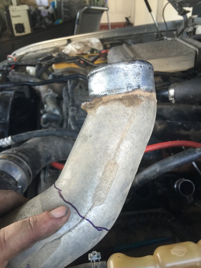

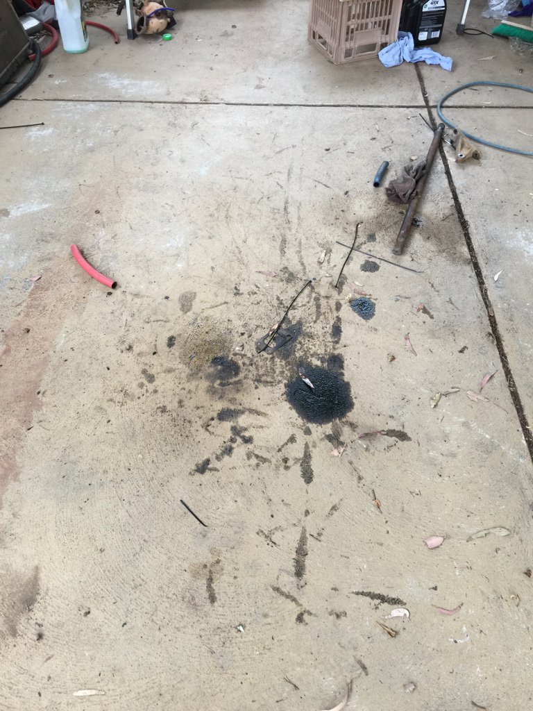

    We made a bit of a mess
