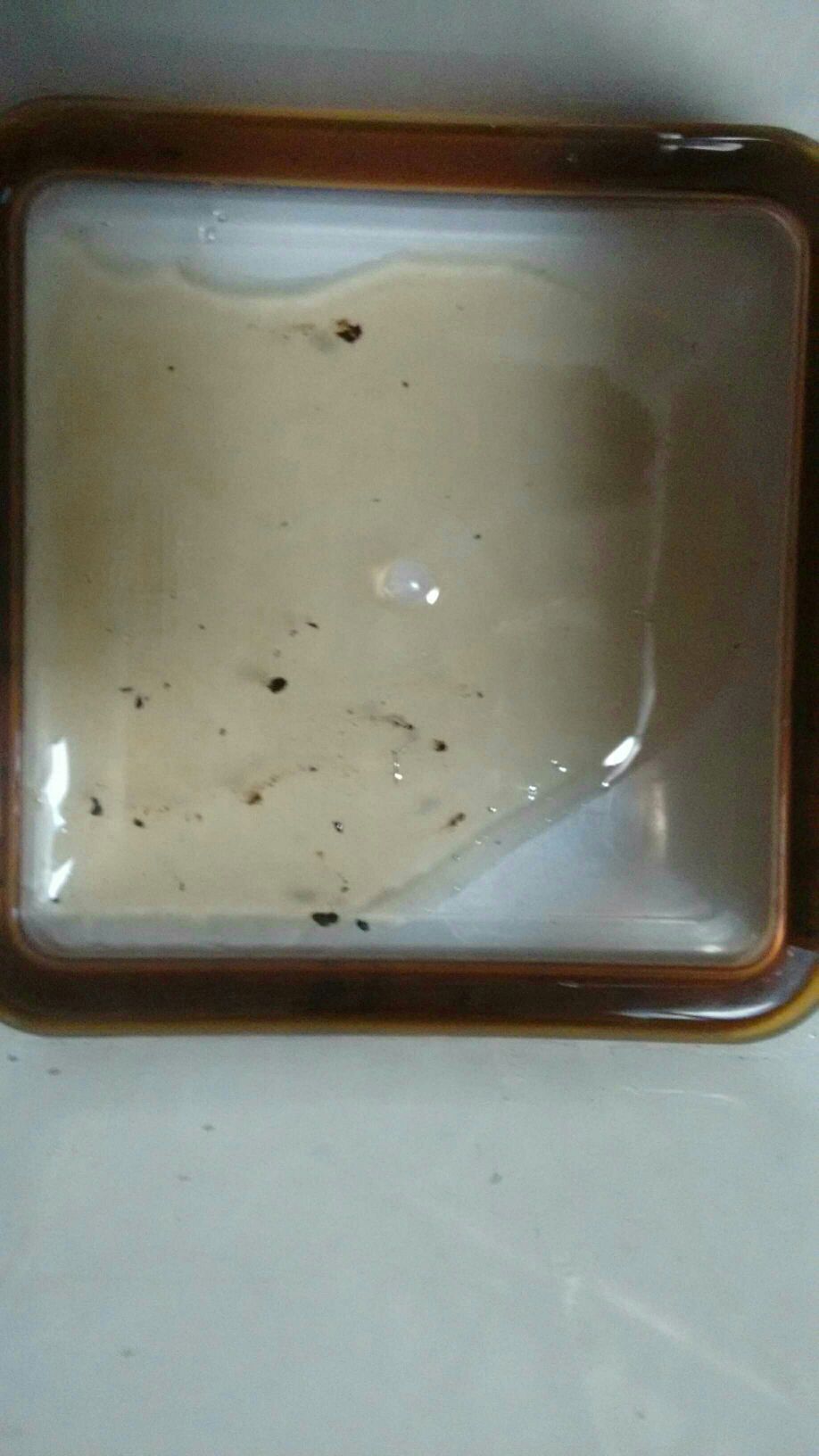

    I took off the level plug that's on the side of the diff to have a look at the condition of the oil and there was the correct amount, but there was a bit if black stuff that probably shouldn't be there.
    I'm going to give this a go. My theory is just a dump and refill won't clean anything.
    Wish me luck...
