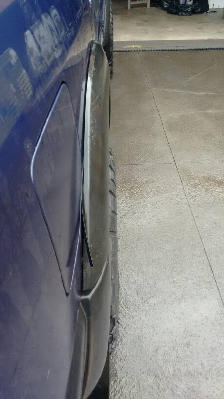

    My Neg 6 are perfect. I have seen Neg13 sit OK too but not sure they would take a 305 and still sit inside the guard.
    I recently fitted 305/70/16 on 16x8 neg 13 on a series 1 GU.
    Drivers side.
    Passenger side.
    This is with a 2" lift.
    Adjustable panhards will recenter the diff, but as you can see it's not a lot.
    Sent from my XT1068 using Tapatalk

    I reckon you'd get done in Mansfield Jay see
