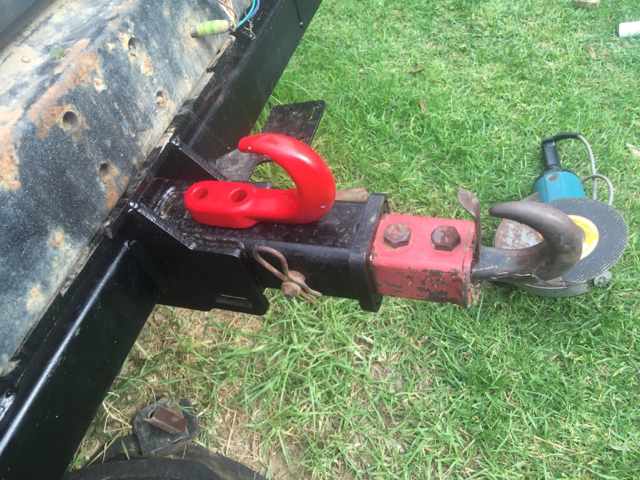

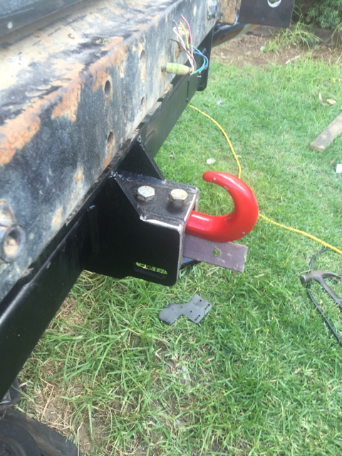

    Well been doing a bit of bar work, my nephew has been down to give me a hand as it's basically impossible to do alone. Coming together slowly.
    Pretty stoked with that!!
    After our experience with a recovery hook Darren I am very surprised you are sticking with one and not using something like this..

    Cheers Paul. My rear bar also has 2 recovery points built in to take a shackle do the hook will be used for towing and light snatching only. As we discussed with a 24v winch snatching will be rare.

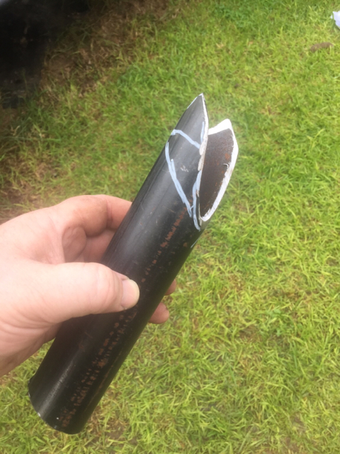

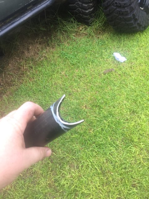

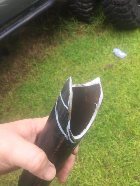

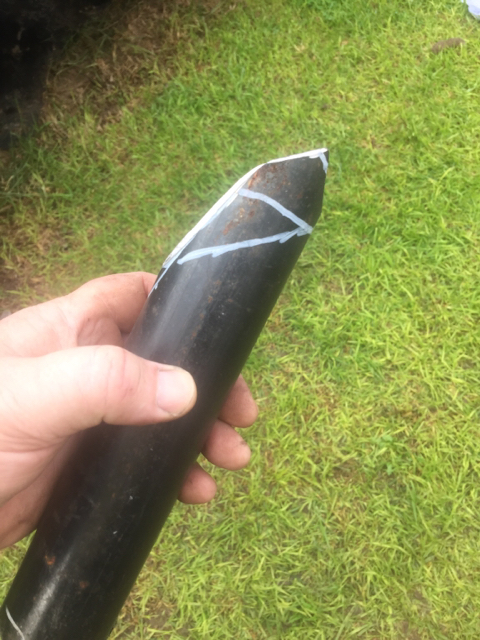

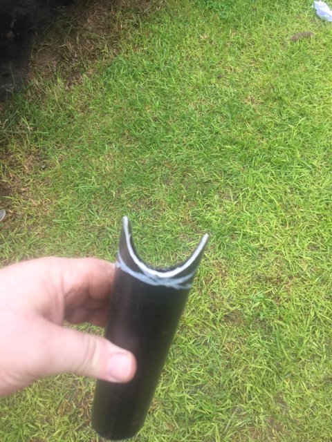

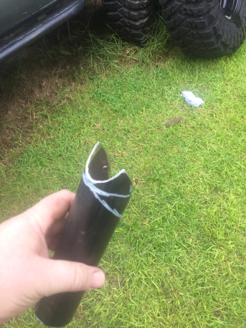

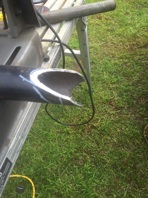

    So been busy today. Stoked with how it's come together. So much work!!!
    Some notching. Getting pretty good at it actually.
    Pretty kool really! I like it anyway

    You're getting good at this Darren
    Tis looking good mate..
    Also a hole saw makes notching a breeze..
    Match the saw size to the pipe and drill away on the angle needed..
    Yeah but then I need to hold it at the right angle. These are hand cut with the 5" grinder and I am doing them pretty quick.
    A bench vise works well..
    Orrrrrr..
    http://www.ebay.com.au/itm/262458679040
    Yeah to be honest I actually planned to buy that notched and use a hole saw. I saw a YouTube vid on hand notching and figured it's not hard so I didn't bother.
    If I was doing a complex cage or something then I'd have grabbed the notcher for sure. My mate who owns the bender has that notcher and I could have grabbed it to.
    All good. Smashed them out.
