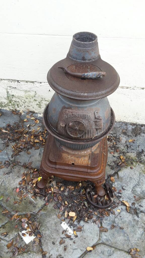

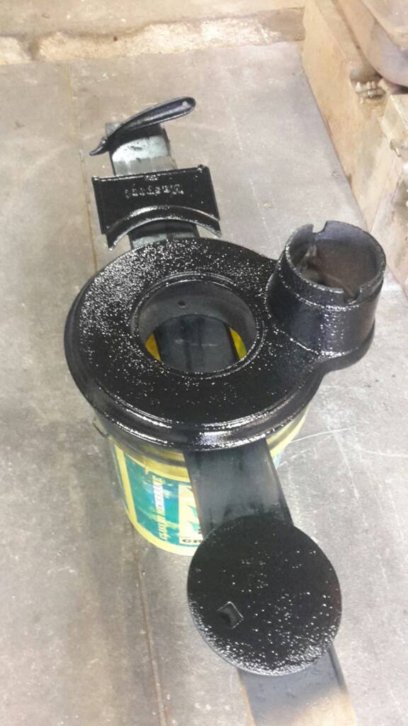

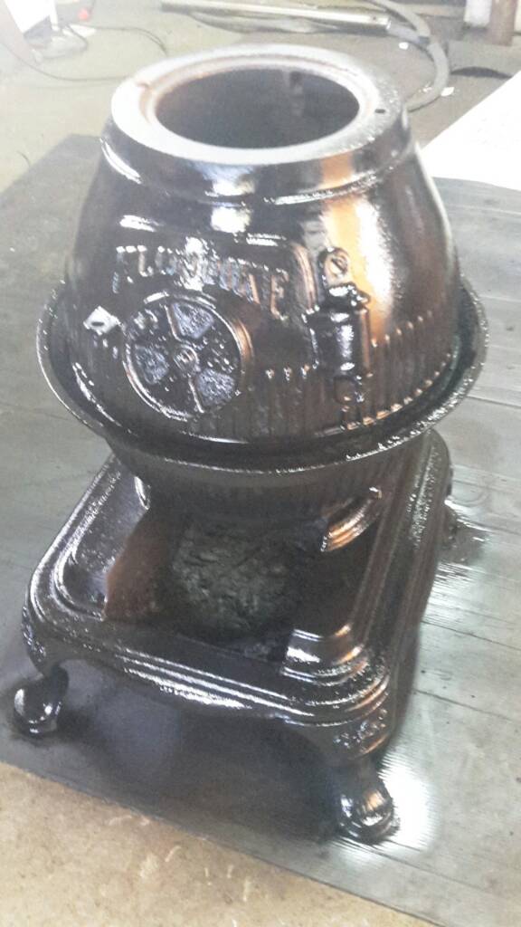

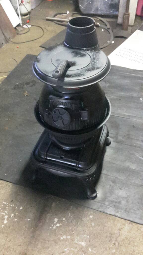

    So after a woful start I finished strong.
    Pulled out the Masport Klondike heater project..
    Wire wheeled the lot and then coated with high temp paint..
    Looking good I think..

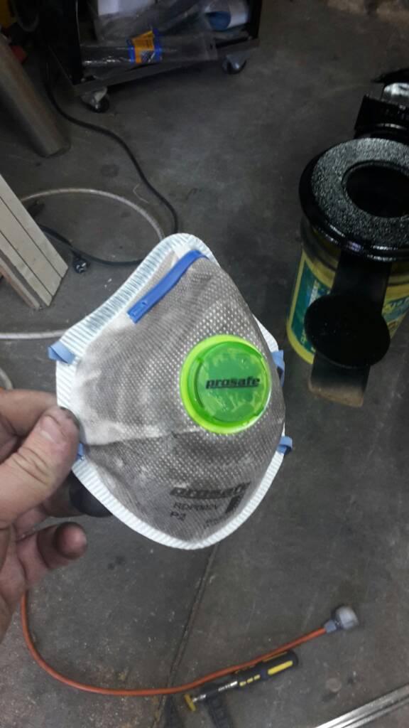

    Always wear a mask!!!
    Tomorrow I'll start a fire and get it to 200c to cure it and then install it..

    We used to have one of those in my mate's shed and we could never get it to burn very hot.

    Looks pretty good, Kallen. Put it outside and make it burn real hot, the first couple of times you use it. That stuff stinks to high heaven, so I found out.

    This one has no rear baffle but going to make a top one..
    Hopefully it works well..
    Yea won't be lighting it in the shed..
    It's for the deck but will light it in the driveway..
    Yea my dump pipe stunk a bit when I baked it..
