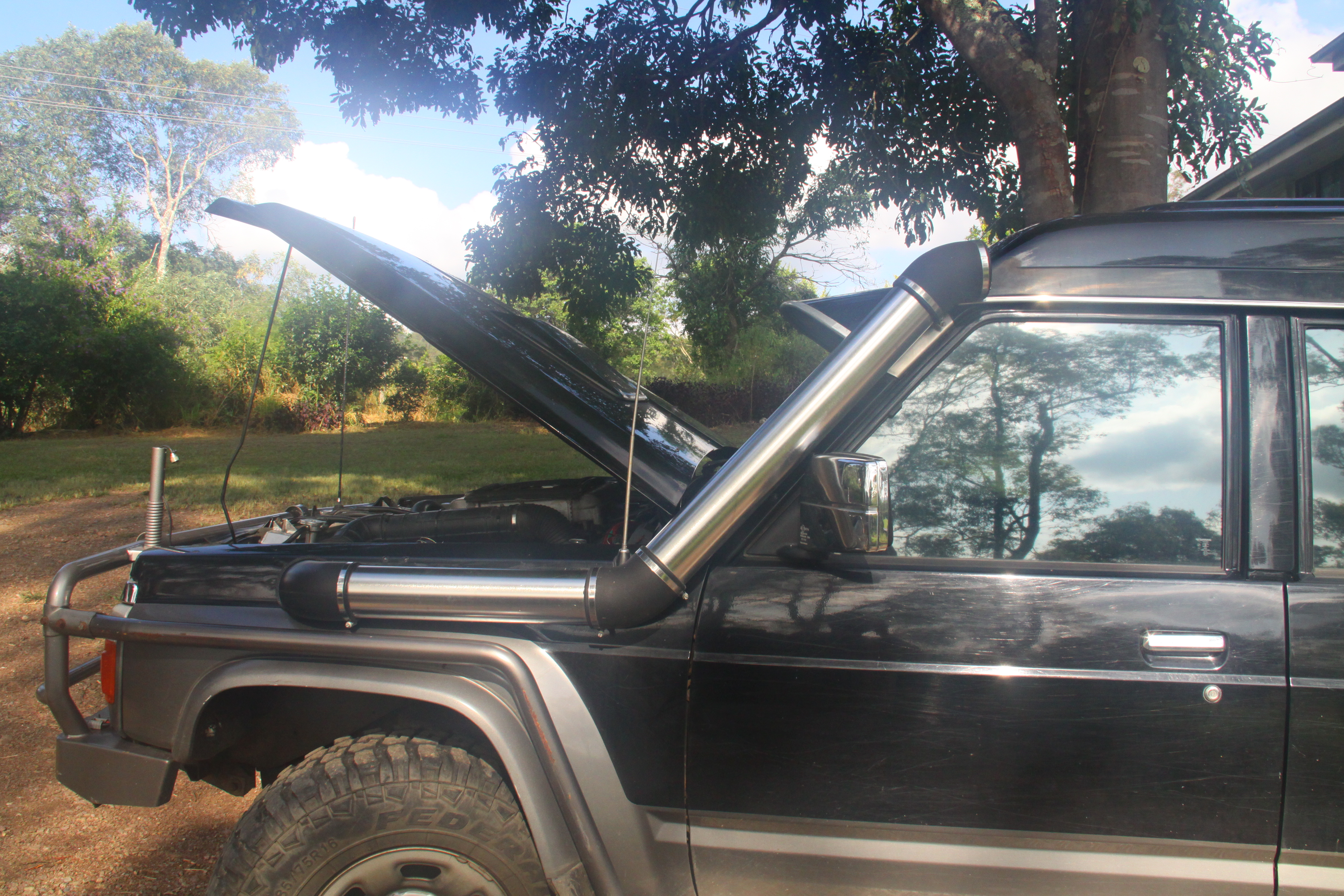

    http://www.isx.com.au/brian/3.JPG
    there ya go 4" snorkel on mine, goes through the guard to donaldson filter then thru piping to the supercharger, i removed the crappy pizzabox as i found it pretty useless.

    shes a ripper. Nice easy build
