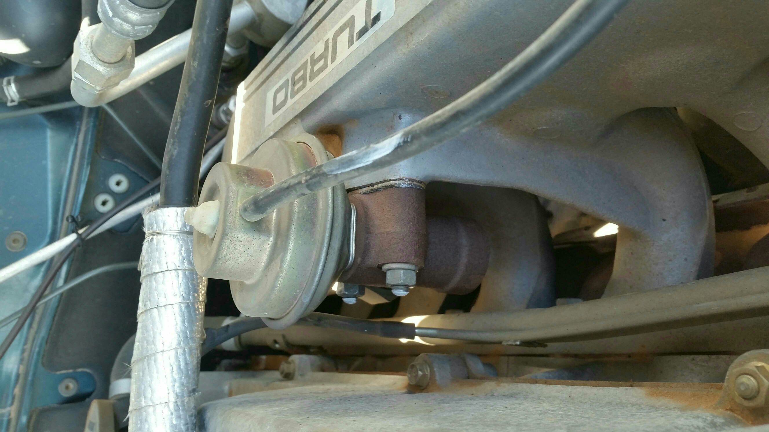

    is this not the EGR here?

    Quote Originally Posted by damian.thomas View Post
    this is from a 3ltr ZD30 though and not a RD28

    Oh ok i have this in my car, so blocking it will have no improvement? I read elsewhere on the forum other people doing. If not i guess its one less thing to do.

    Ok my bad... Yours does have the egr valve. Yeah bloke that shite off mate.

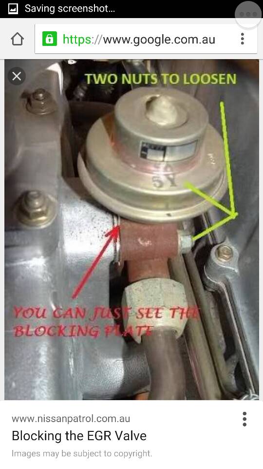

    Hey guys
    I got around to making the blanking plate today but when i loosened the two nuts and moved the egr valve to put the plate in i seen that the gasket was stuffed.
    I put the plate in anyway went for a drive to see if anything changed and i noticed in third and forth gear when i put my foot down it would rev up to 3000rmp but not pick up speed very quickly. I figured it was leaking from the egr valve because of the gasket, so i went to supercheap, autobahn and repco and nothing in the ways of gaskets for the egr valve.
    The guy at repco suggested gasket paper so i got some when home tried it and still the same thing.... has this happened to anyone else before? Could it be something maybe? Or does it seem like it is leakingfrom the egr. Any help would be great.

    Cant say for sure coz I drive a TD42, but if th RD28 is like the ZD30, then maybe the computer needs to relearn..... I think disconnecting the battery resets the computer.....
    Hipefully some of the more knowledgeable members will chime in
