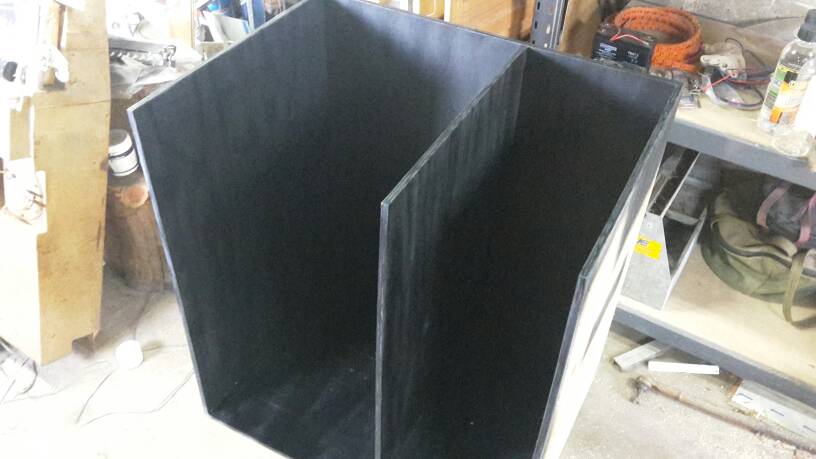

    So as much as I love the outback draws in the gu..........
    By geeze I would never spend $3000 on em.. they are tiny and a huge waste of space.. But with the child restraint in built they are better than a full custom draw..

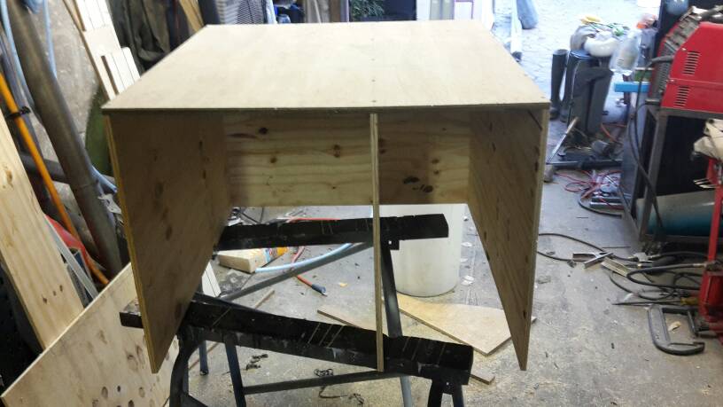

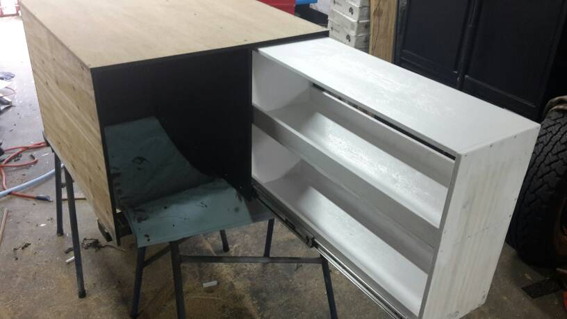

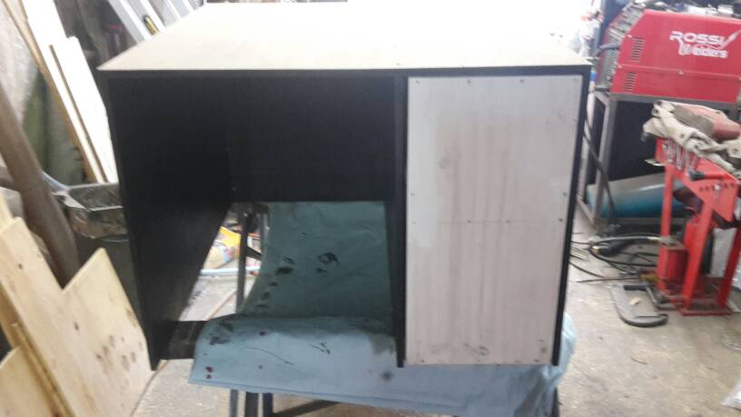

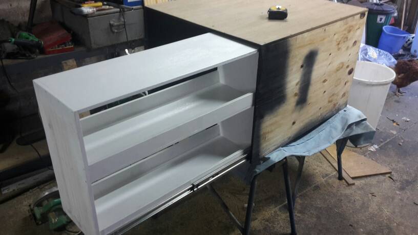

    So due to lack of space I've had to build a vertical pantry...
    It's a fridge enclosure and draw next to it.
    So a sheet of ply and a bit I now have a pantry..

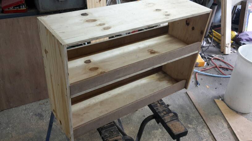

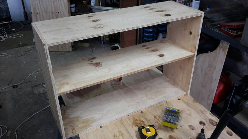

    I splashed out and went runners with this draw due to its height as it would have fallen out with just nylon runners..
    The bottom shelf is 260 high so a bottle of sauce fits... and a 6 pack of beers....
    Draw is 250 wide and 760 long..
    Still to carpet and fit handle, then fit angle alloy to the sides to secure it to the draw tops..
    But close..
