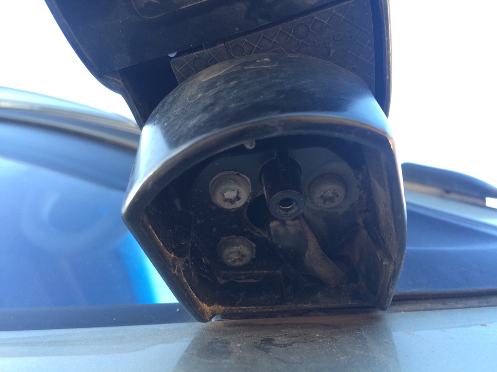

    What did you do to your Patrol today!
    I'm probably like Sandra Sally with the late news but I've seen from time to time people asking what's the go with the shaky mirrors on a GU, I undid that little screw underneath and the plastic cover comes off then there's three torx screws there , They were quite loose , I did them up and hey presto no shaking mirrors, only taken me 12 months to get onto that , the poor patrol plays second fiddle to the truck when it comes to maintenance & fiddling with stuff

    Something ive been meaning to do too....
