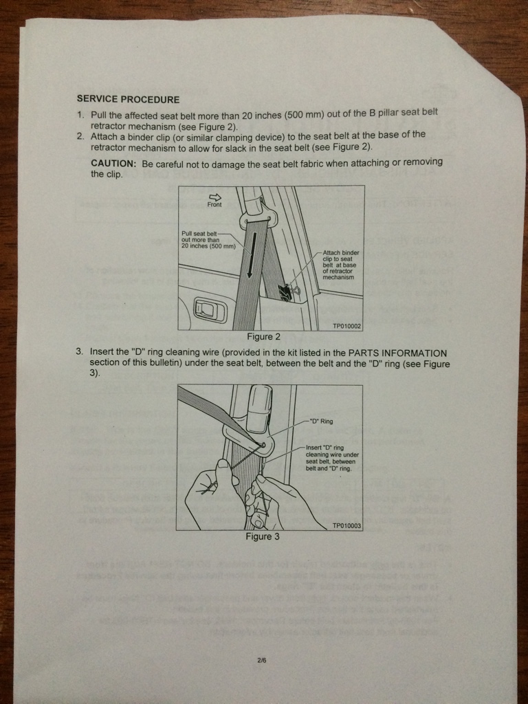

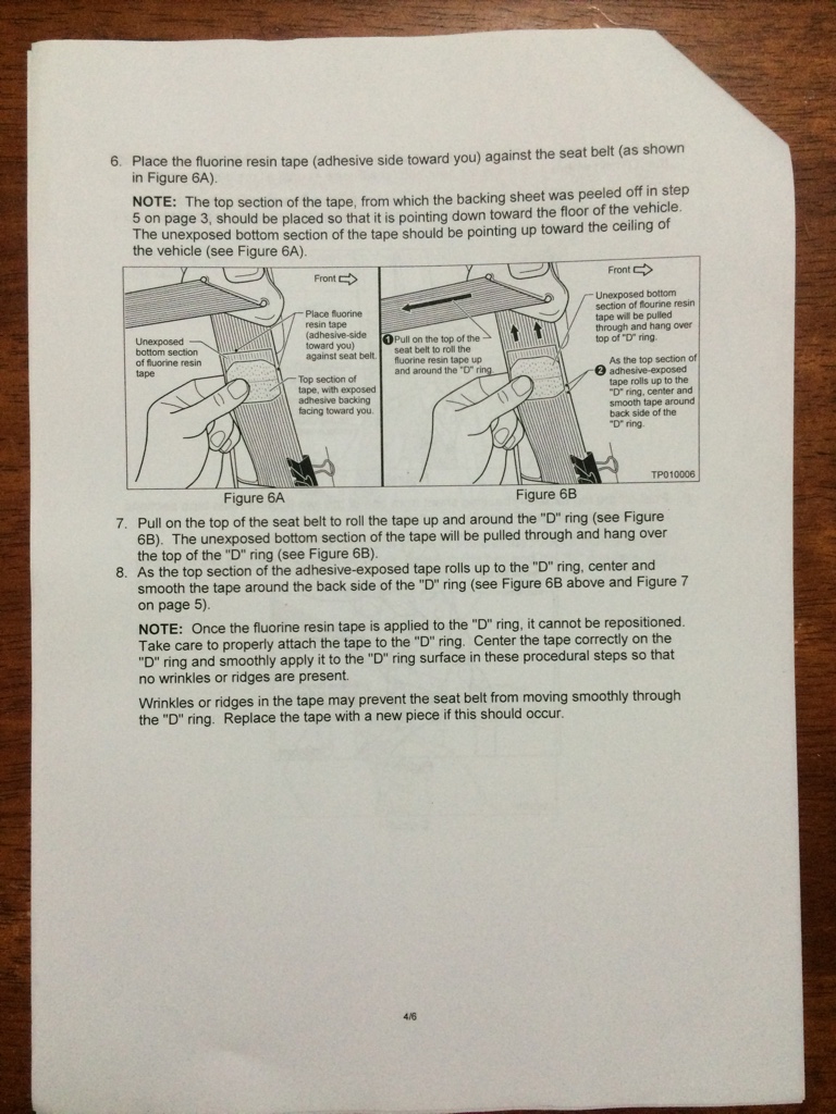

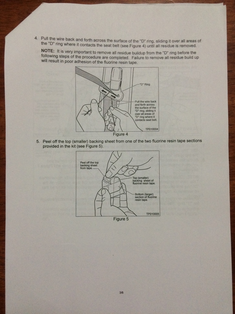

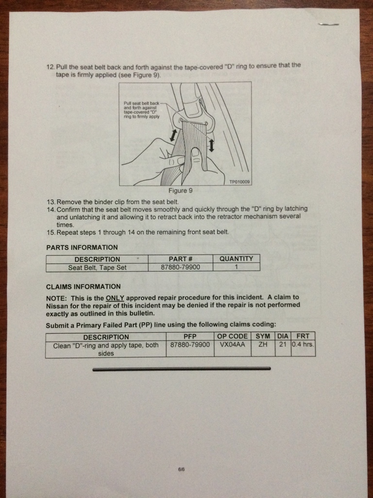

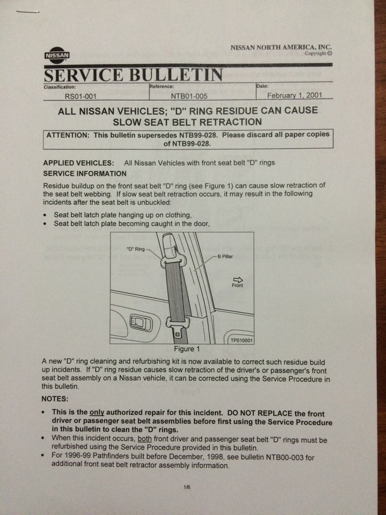

    Yep - seen that before as well. I have used many, many different seat belts in different cars over a lot of years and I never had to use "cleaning wire" or "cleaning tape" or any other shyte. The belts have always worked - except in Patrols.
    The fact is the wind mechanism in the belt loses its tension reasonably quickly and just won't work. You would think that after years of this crap Nissan would have woken up to the fact some time ago and replaced the belts in later cars - but they didn't. When I installed the new belts I tried to pull the old ones apart as I thought they could be wound on a bit more. Good luck trying that! The after market ones work perfectly.
