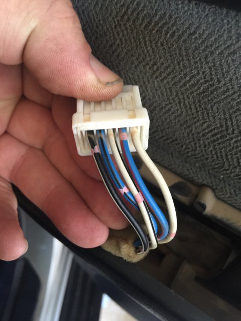

    Well yesterday I striped off a handle only for a look. Got the multi meter out and found 12v power at the window switch that had constant 12v whenever the accessories was turned on on the ignition. That will do me fine.
    I gave Yendor a call to run my plan past him and confirm the window circuit could handle the extra load. All good. He recommended I grab an earth at each point though rather than the existing earth as that went back through the drivers door control circuit.
    Here is a very quick and simple job that will make life easy on the road!!

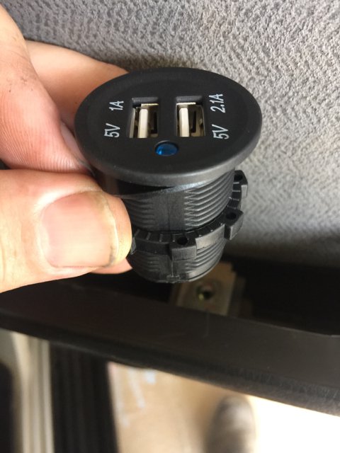

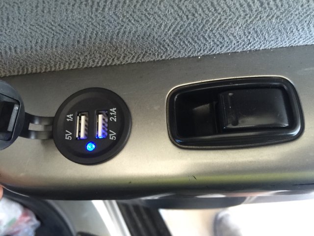

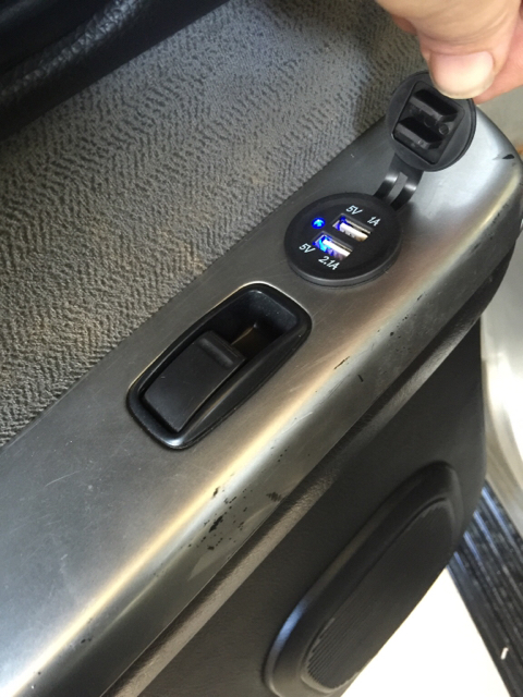

    The USB dual plug off eBay.

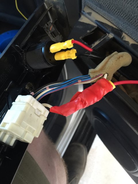

    The window plug disconnected. The White wire with the silver band is the one you want. Far right.

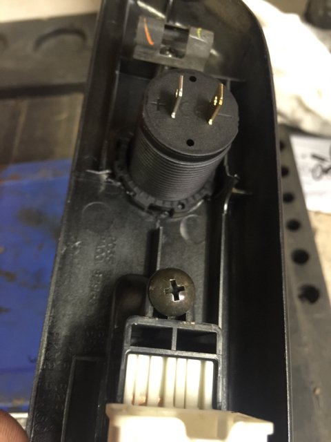

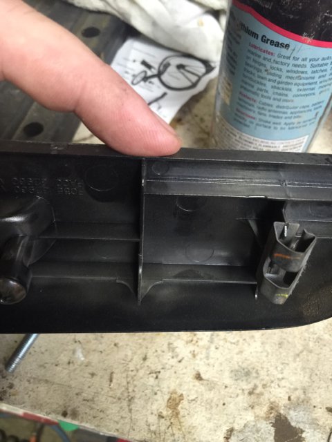

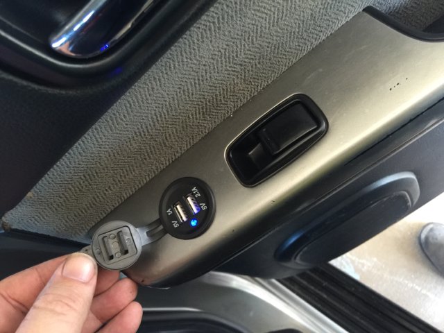

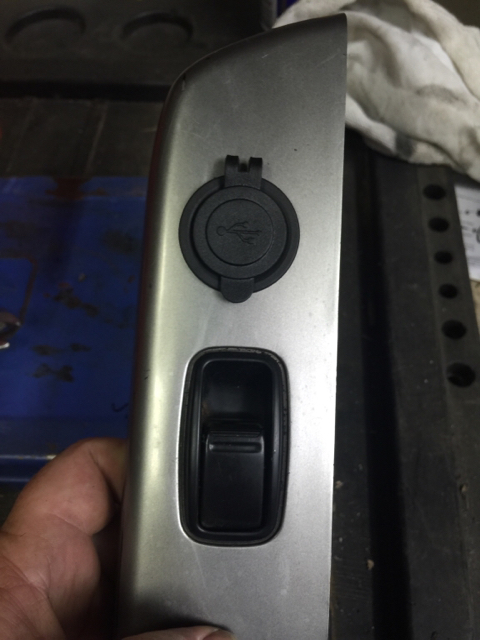

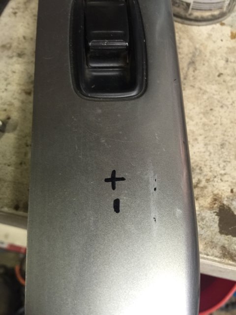

    Now note that there is structure under the trim. Drilling from the top using a hole saw in a drill press I drilled through the structure.
    I broke off the tabs left using a pair of pliers so I could tighten the locking ring on the back.
    Happy days.

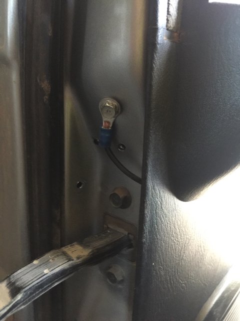

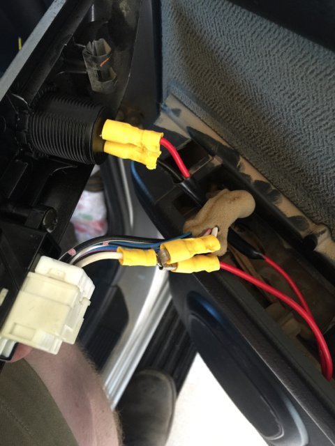

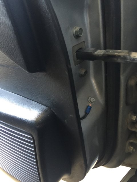

    Now I made a loom long enough to go from the underside of the plug, down into the handle, behind the trim, out the the hinge area. This is were I grabbed my earth.
    Now I cut the white wire with the silver band and using a 3way crimp connector I spliced into this wire
    And Bob's ya Aunties Grandma!!!

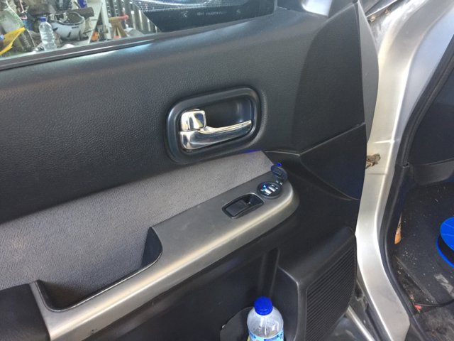

    So the first one probably took 40 minutes including nutting out how I was going to do it, changing my mind, calling Yendor and finishing the job!
    Wiring up through a switch from the second battery to the centre console then making a loom out to each door would have taken a good 4 to 6 hours I reckon.

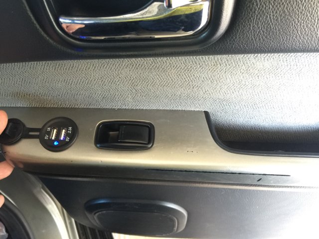

    The other passenger door took no more than 10 minutes!!

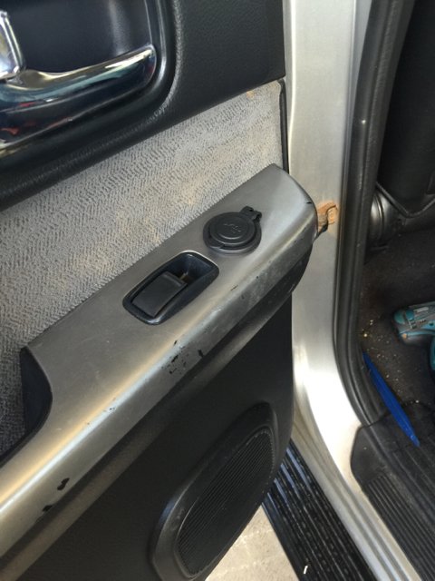

    The front passenger door didn't miss out either
    All three doors in about an hour!!! Stoked with the outcome! Thanks Yendor for your advice mate! Winner!!!

    I have done similar but my issue is that my phone, my tablet and the kids tablets use 3.1A outputs. I have one of those Baintech sockets, same as yours, and the anp rating is too low so i have found it takes longer than usual to charge.

    Yeah the standard 12v jack is a 2.1amp or a 1amp. That say the iPhone needs 1amp and the iPod needs 2.1amp. If you charge an iPhone on a 2.1amp charger it's like a fast charger. The iPad will maintain charge on the 2.1amp port if it is in use.
    I ran hema maps on my iPad for the Simpson trip. It maintained charge and recharged on the 2.1 but took most of the day to climb back up when I drained it.
    Each door got a 2.1 amp and1amp port so should handle the job. I was a little concerned with the load but Rodney was confident it would be fine. Happy days.
