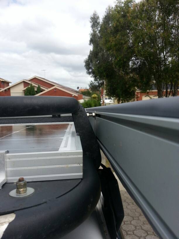

    Hi all
    Mounting an awning today on the roof rack. Due to the angle of the rack side arms, the awning is on a slight angle. When setting up the awning i noticed the side arms seem to point a bit skyward causing them to bend slightly when all connected up. Is this going to be an issue or is this normal?

    15 Post(s)
    I had the same issue so I made a couple of angle brackets to make it verticle. Bolted the brackets to the cross pieces that hold the rack.

    This is what i did....short bolt in the bottom and a longer one at the top with a nut on either side of the roof rack brace so you can adjust the angle...

    Thanks three dogs. I am a stubborn male so I'll see how we go haha.
    Mudski, is that the L bracket with a longer bolt on the top to a drilled hole?
