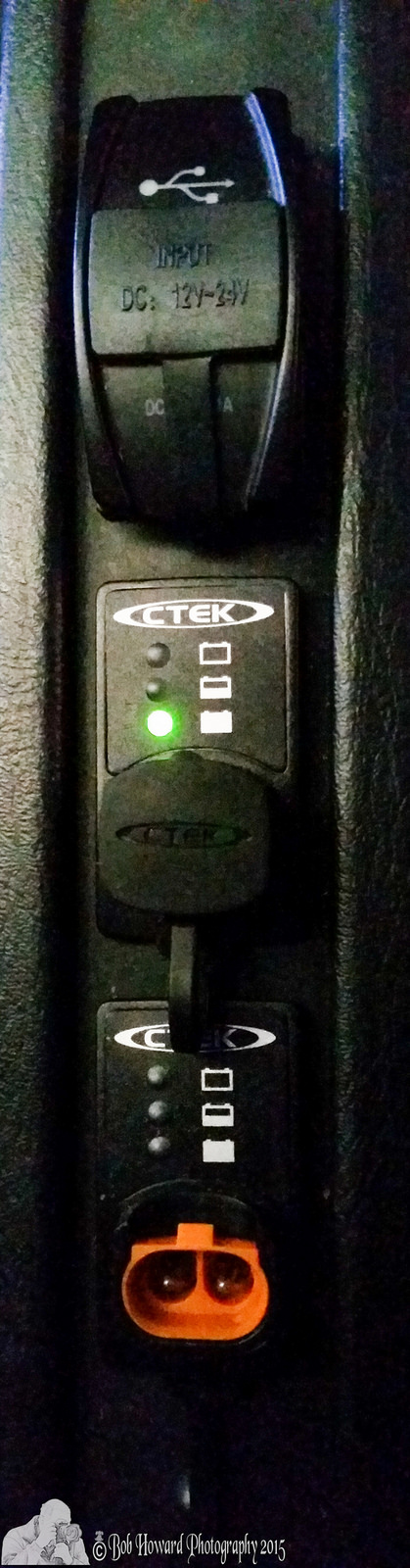

    This what I use for my CTEK. They're located in that strip on the centre console. Middle panel monitors the cranking battery and the bottom one monitors the auxiliary battery. Leds give a rough idea of the state of charge. If I need to charge either battery, I just plug the CTEK into the appropriate panel....
    20160202_181835 by Bob Howard, on Flickr
