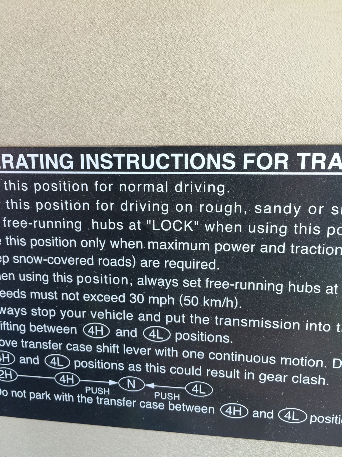

    45 Post(s)
  15. #29
    Sep 2012
    Mount Gambier, SA
    13,585
    16,053
    Them there are just guide lines.. lol
