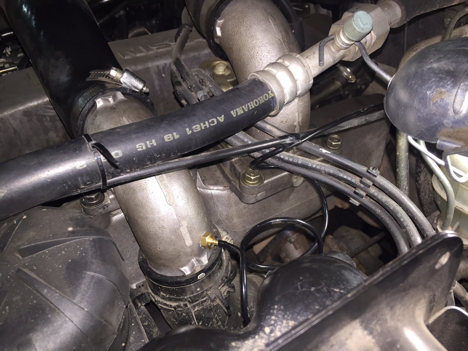

    Had a guy install my boost gauge and I'm wondering if he tapped into the right place for a reading. He tapped a thread into the intake manifold just past the turbo. This seemed a bit odd but he was insistent that that was the best location to pick up the boost. I thought you simply picked it up from the vacuum line running from the injector pump to the turbo?
    Can someone clear this up for me? Did he do it right or do I need to tee into the vacuum hose? Here's the picture of what he did and the instructions for the gauge install.

    not familiar with that motor , but if its on the boost side why not.
    On my mighty ZD30 they drilled and tapped a hole under the ic.
    Im changing that to a plate that fits under the OE boost sensor
    neater imo
    Heat that tubing up in a cup of hot water , you'll be able to push it on further
    maybe even use small cable ties

    I'll be taking it for a drive today when he's done to see if it works right. If it doesn't, I'll cap off that hole and tee into the vacuum hose. Does you boost gauge register when you just rev the engine or do you have to be driving it under load to get an accurate reading?

    Took it for a drive around the city and it sits around 5psi accelerating about 1/2 throttle. If I really punch it, it jumps to 9.5-10psi. Haven't taken it out on the highway yet because I need to replace my front hub seals. Does this seem like it's reading the right boost #s for the 2.8?

    Sounds right
    Light load should be around 3 to 5 psi full load and say over 2,000 rpm then 8 to 10 psi
    so looks good
