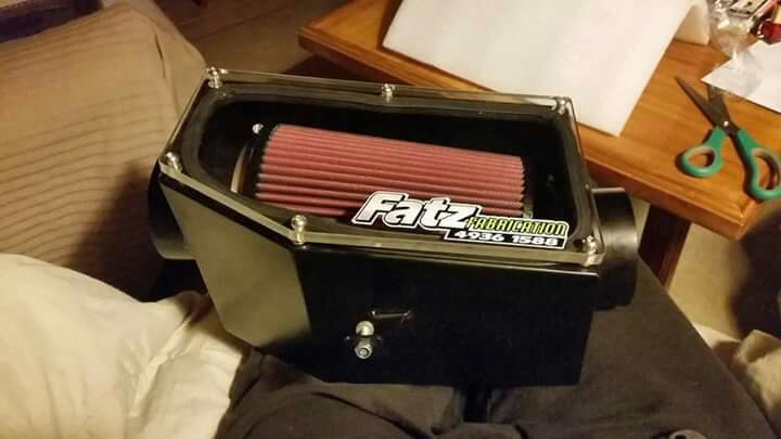

    Looks like i need to upgrade my airbox too.. going to get one frm fatz fabrication... same as this pic...

    Why doesn't the stock zd box fit??
    Does it differ much from the td vertical box?
  7. #55
    Expert mullet_hunter's Avatar
    Feb 2015
    perth.. norf of the rivr..
    447
    138
    Thanked 113 Times in 83 Posts
    The zd box fits... but its highly restrictive with the ls.. they like to breathe..

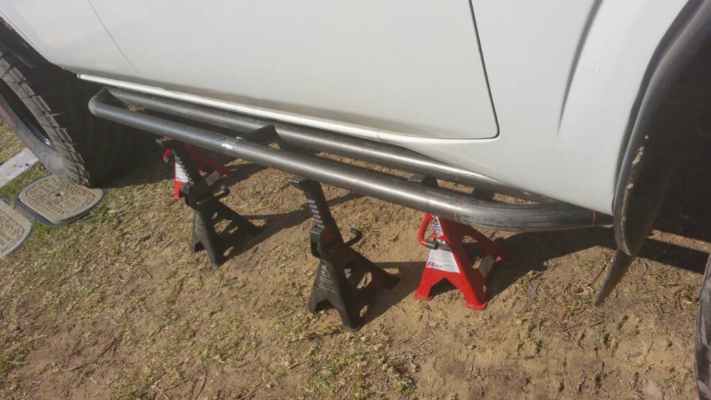

    Sime lazy sliders i was knocking up for the pooey and the bro's prado..

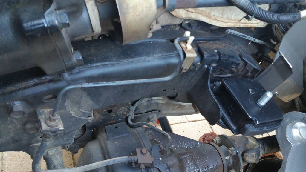

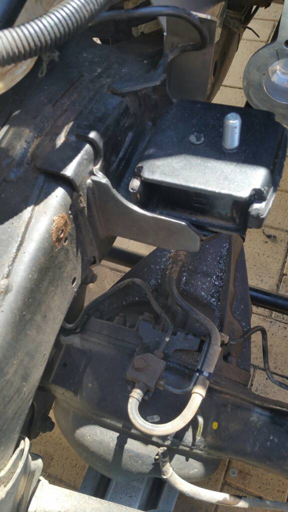

    This brake line needs to be moved as it will faul the aircon...
    Like so...
    Sent from my SM-N915G using Tapatalk

    Do you have any pics of the fuel lines? Did you just bend them out or cut and join?
  13. #60
    Feb 2015
    447
    138
    Ye you just move them from the side of the chassis rail to the top side... the heat shield will will cover everything ontop of the chassis rail... dont cut them... im gona use speedflow fittings that go streight frm the hard lines to dash 6 fittings.. and frm there to my regulator/filter then onto my fuel rail...
