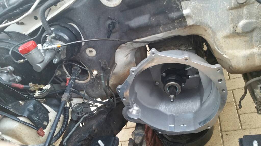

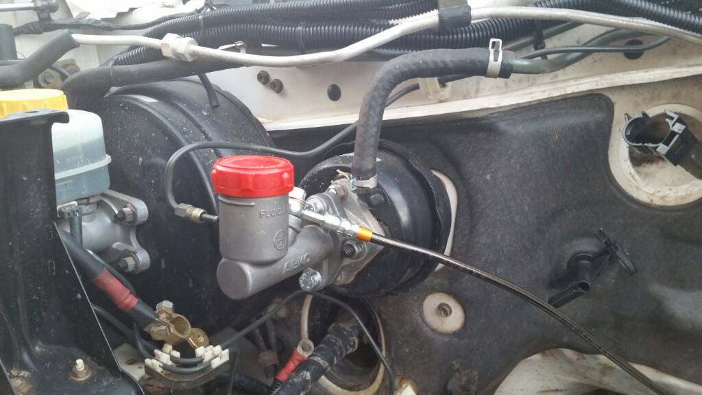

Fittd new clutch master n braided line dwn to bellhousing..

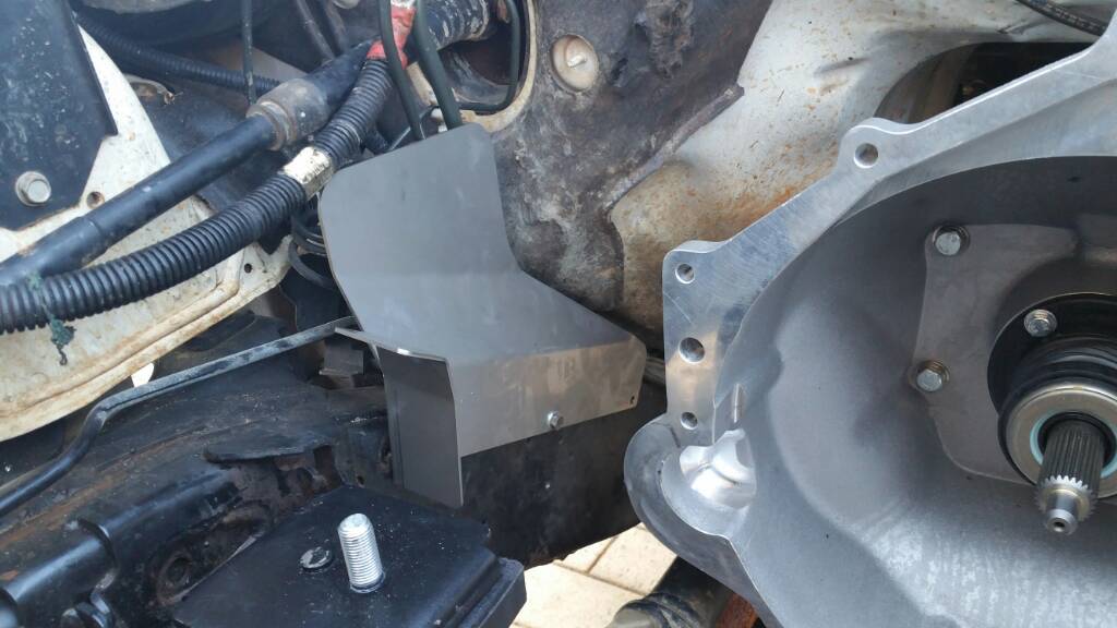

Lazy heat shield to protect brake and fuel lines frm headers... should keep everyone happy..

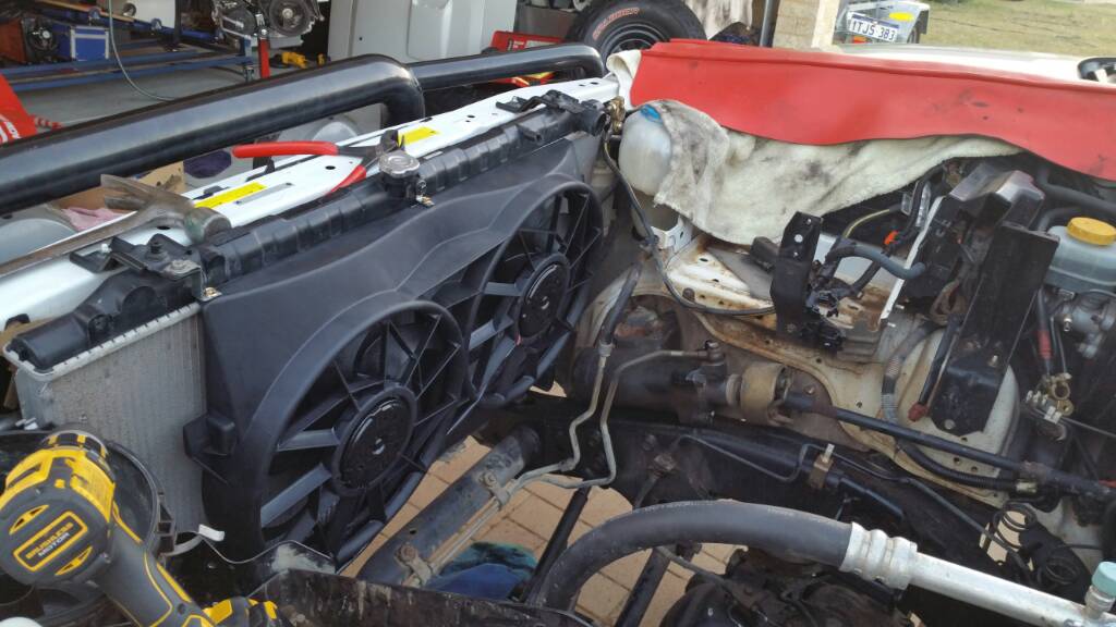

Made up my flash boy racer power steering lines...

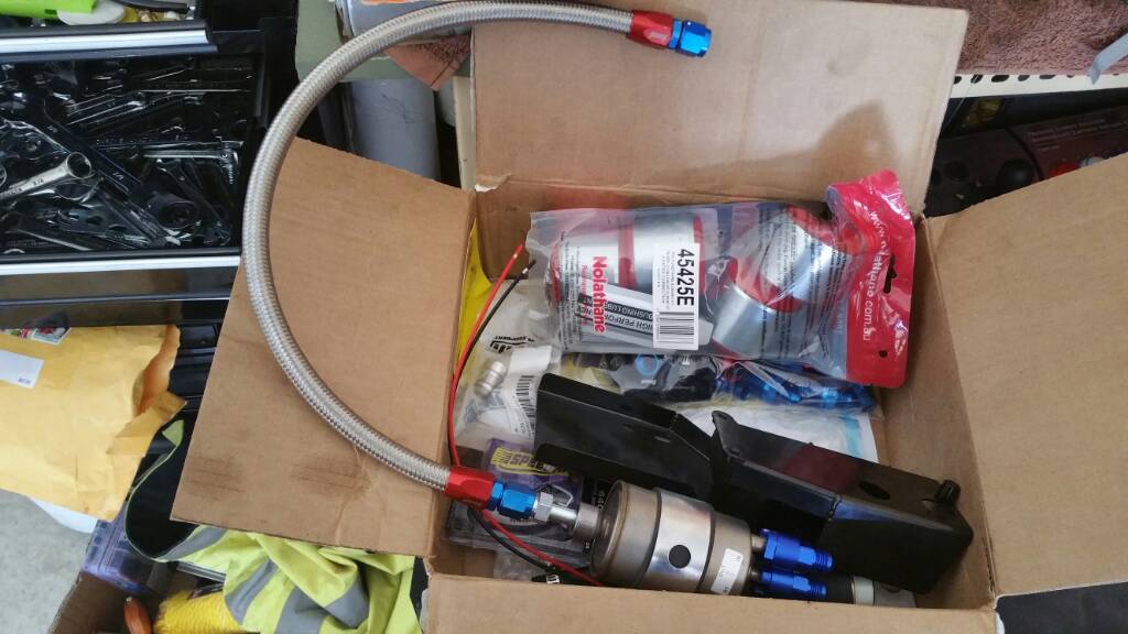

Fuel line from regulator to fuel rail...

Hey mate, have you got any photos of what you did to the fuel and brake lines. Having the same dramas with exhaust on the windsor conversion.
They need to be moved frm the side of the chassis rail to the top side.. then the heat shield installd to cover them...
Sent from my SM-N915G using Tapatalk
Have only done brake and fuel lines.. still need to do diff/gearbox breathers on the passenger side... then engine bay should be pretty close to dropn in the ls...
