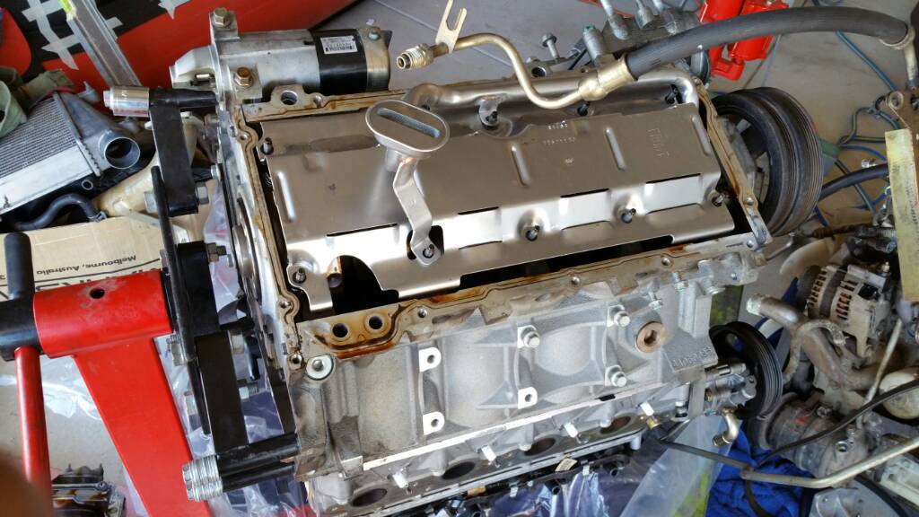

    Welsh plug that needs to be punched out for new dip stick...
    Removing plug and refitting sump..

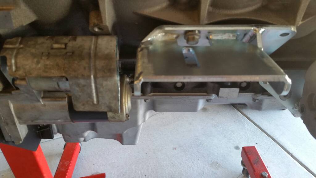

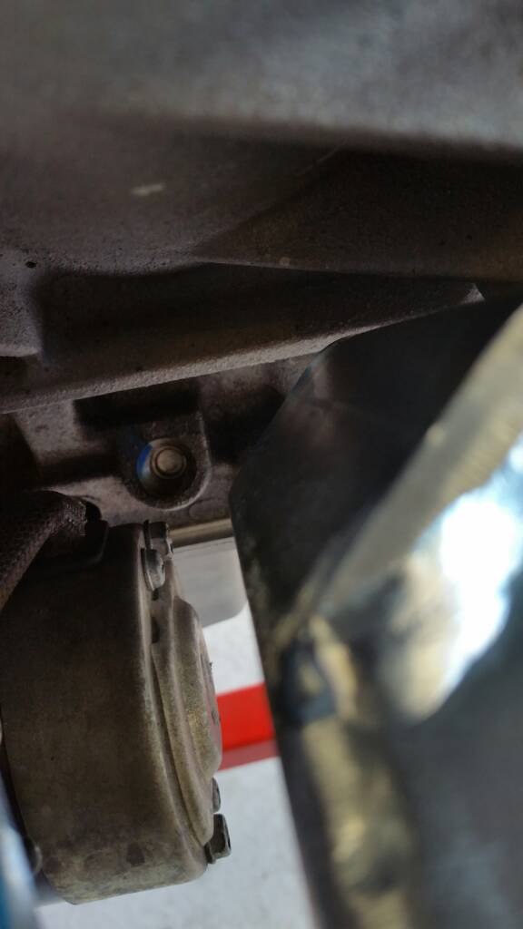

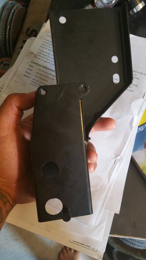

    Pic of starter n heatshield cut dwn to clear the drivers side engine mount...

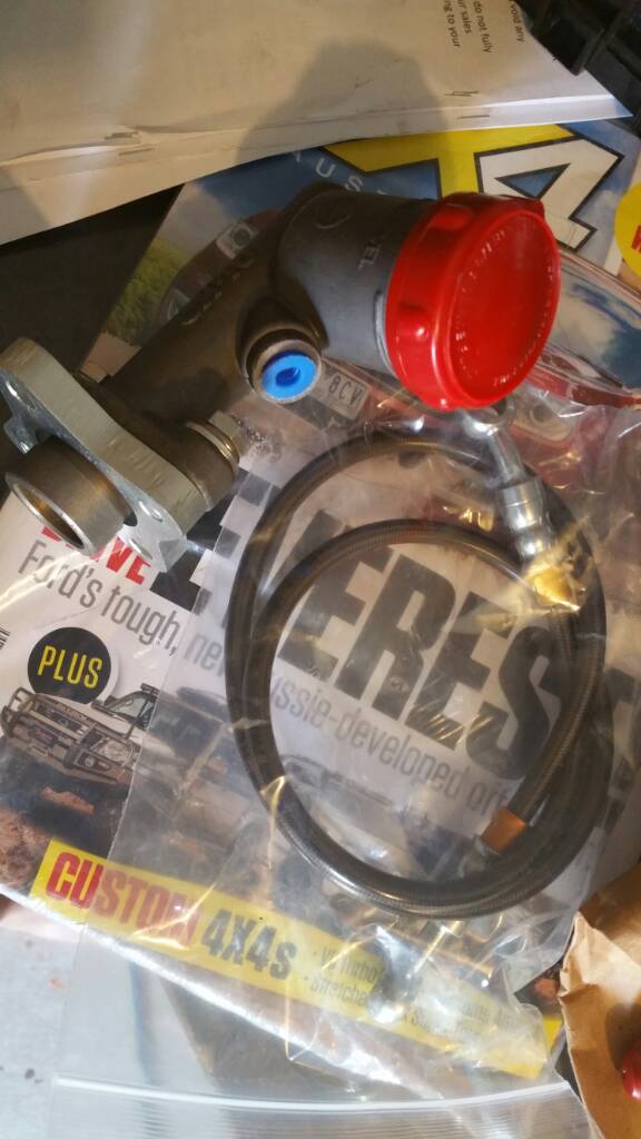

    Pedal mount asessbly.. for fly by wire pedal..
    New/bigger slave and braided line that comes wiv the marks bellhousing kit...

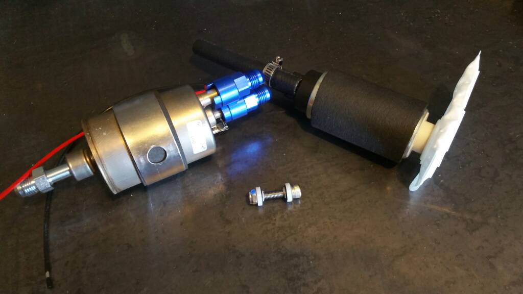

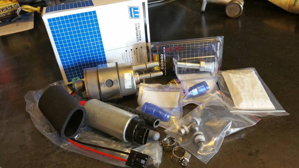

    Fuel system...
    Corvette style reulator/filter and walbro intank pump..

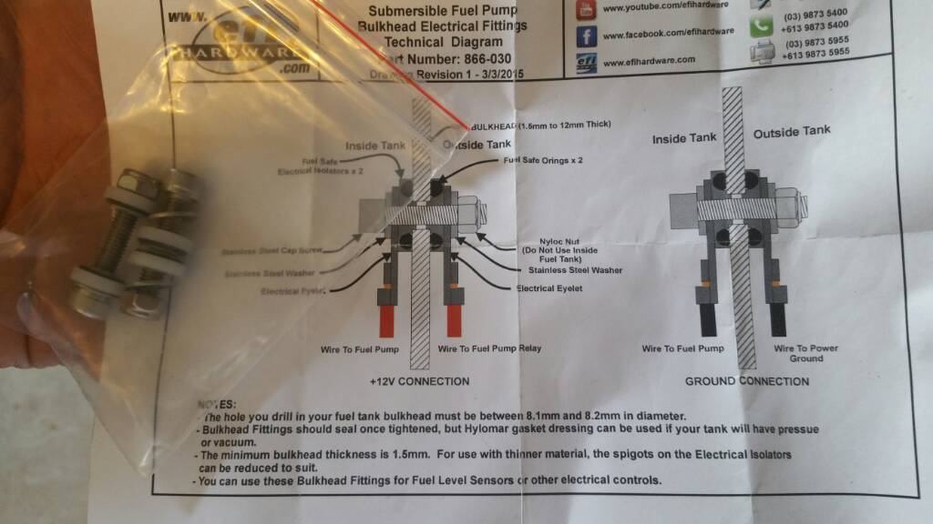

    Most people just use a 4.5 sender but il be modifying my zd30 sender to suit... the picture above is of the bulkhead fitting.. which will keep my fuel tnk sealed and alows me to run a single power feed wire to and frm my walbro pump instead of just drilling a hole and patchn up with silicone like most average joe blows do..
