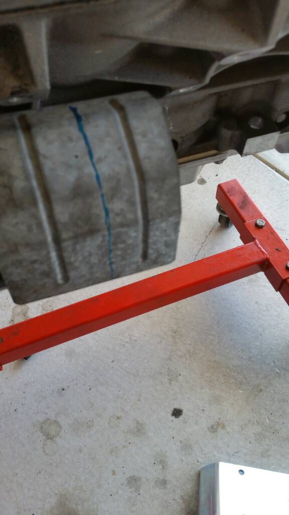

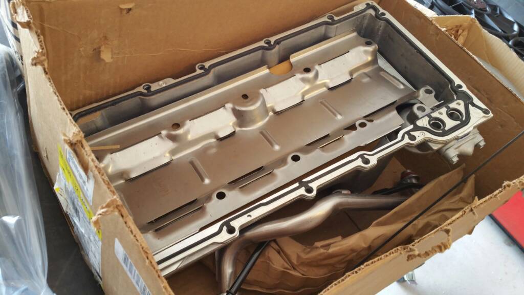

    Rear sump..

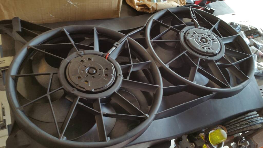

    Au thermo fans..

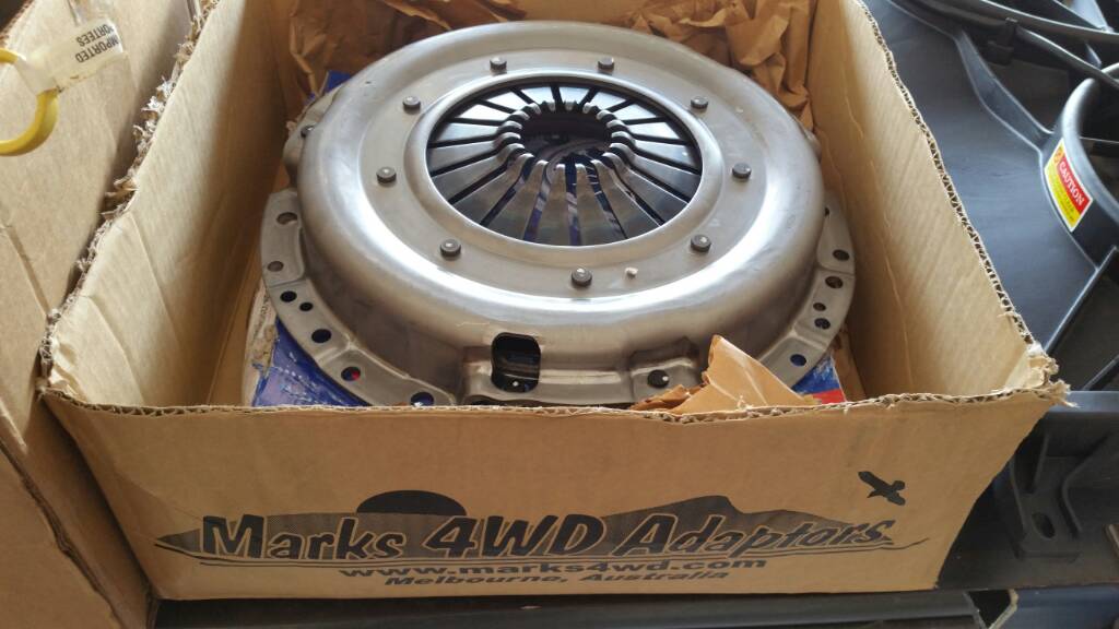

    Clucth n flywheel..

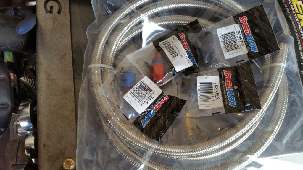

    Fittings and line to make up power steering...

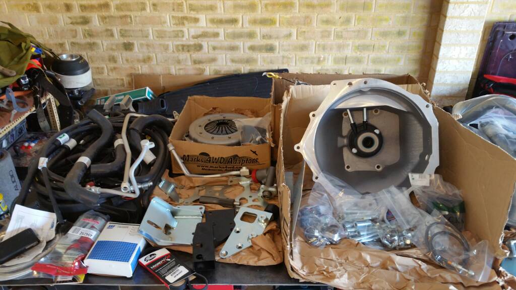

    Bellhousing... hoses n other shite..

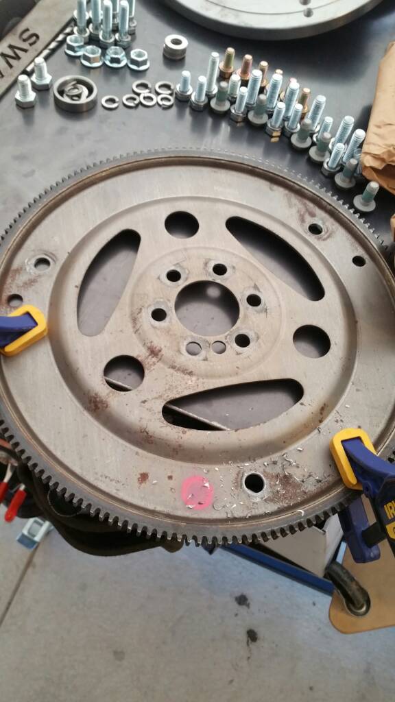

    Flexy getn drilled out to bolt to new marks flywheel... the slot need to be drilled out to 13mm...

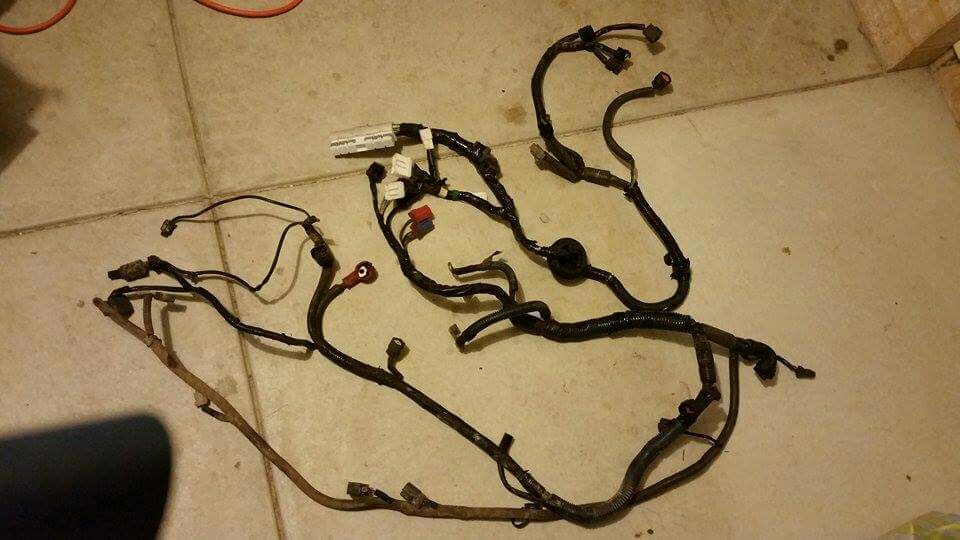

    Strippn out looms to be away so i can get spliced to ls loom for a true plug and play wiring loom...

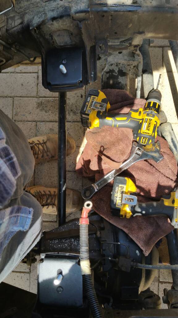

    Engine chassis post drilled out to suit the new rubber mounts...

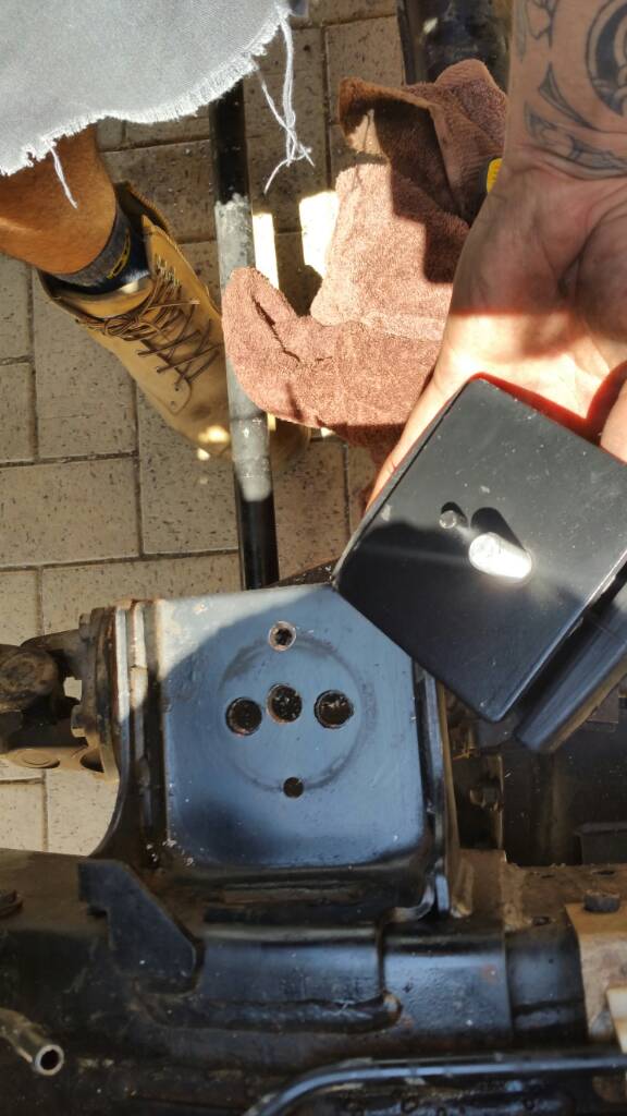

    Rubber mounts fixed in the engine bay...
