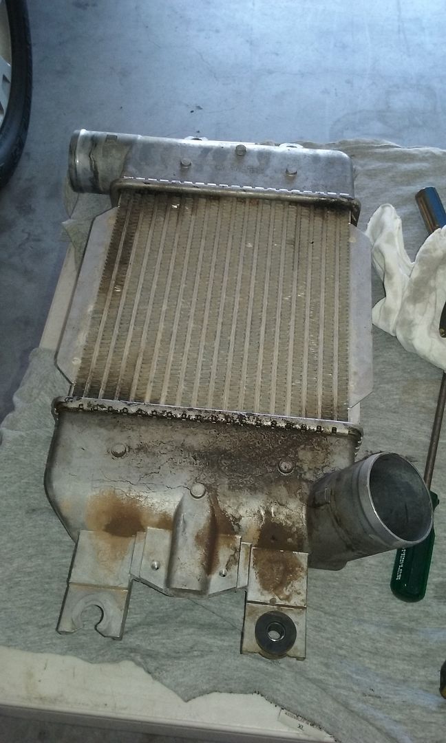

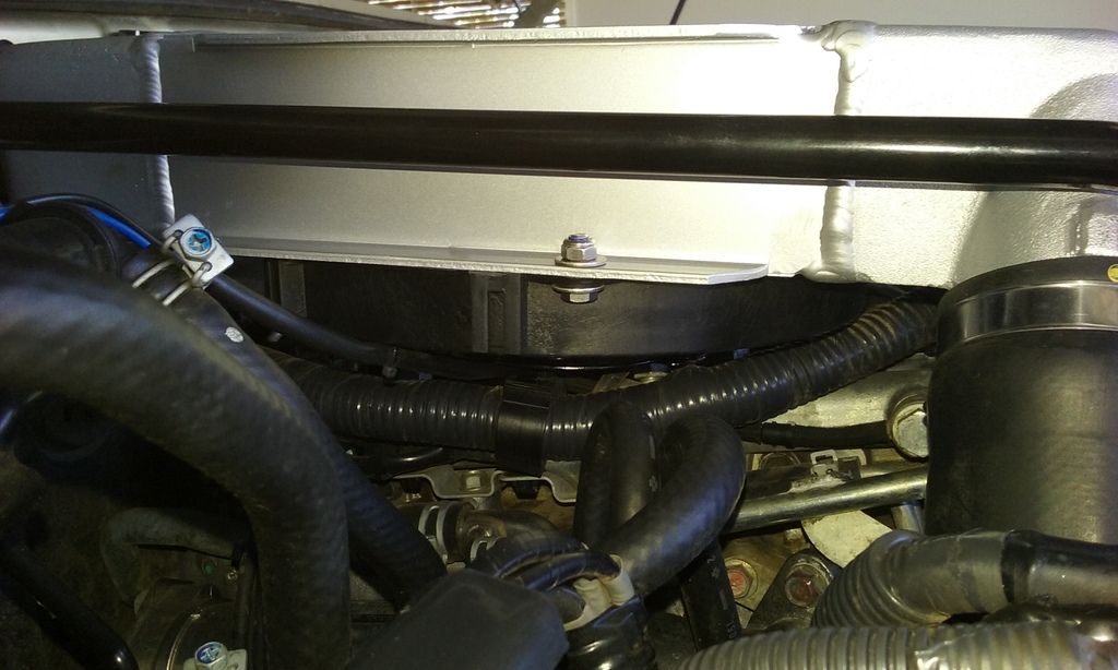

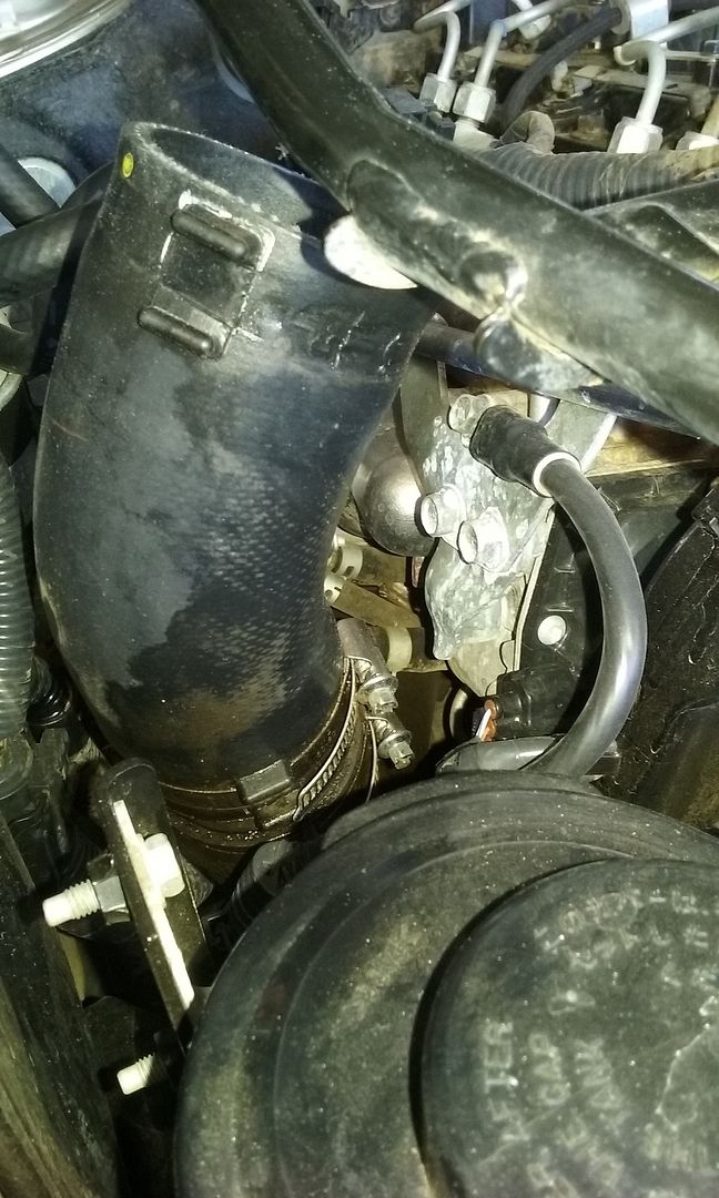

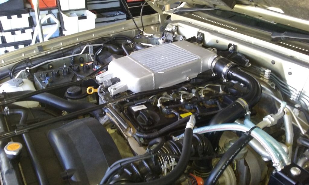

    well i decided to bit the bullet - fitter the Boost and EGT gauges, catch can , new inter cooler, blocker the EGR, and a Inter cooler fan
    Results - running 100 deg lower at 110kmh
    Boost maxing out at 18 PSI, but spooling up earlier - feels better to drive (not dawes or boost control fitted)
    And i was very shocked at how much oil was in the old inter cooler and pipework before i fitter the new one.
    here's the pics ....
