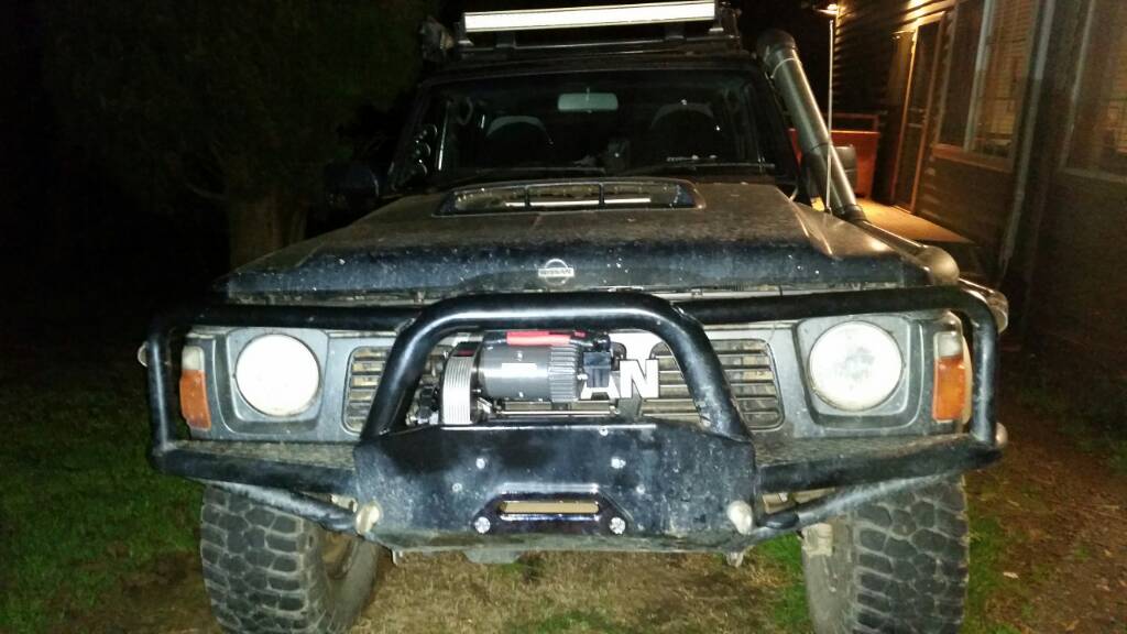

    Bar isn't bolted on yet just sitting there, that can wait until tomorrow. I am so stoked =)
    awesome Winnie, so that bar is lined up with the chassis holes?
    No grille cut with the brace?
    That's a huge bonus!

    15,849
    7,305
    No grille cut =) heaps of space behind! About 20mm
    Yeah nice perfect! ! Not long now. . . Good job on the bar too.

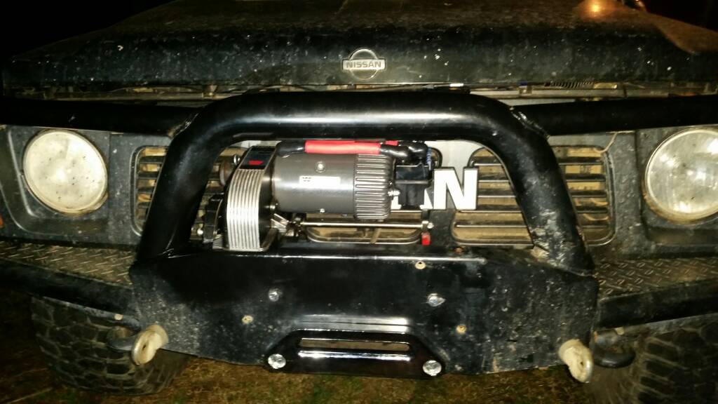

    The bloody template from Millweld was wrong, so my mate did a good job but I had to grind it further, so now it's not as neat as it was.
    What happened, did the brace end up hitting the grille?
  14. #239
    15,849
    7,305
    What is it with your obsession and cutting grills! haha no the gearbox fouled on the bar, I had to grind it further but all good now.

    how did the heat effect the powder coating or is is sprayed ??
    Need a canvas cover to protect from the elements when not in use.
    Fantasic job all Patrols should have a hi-mount. lol
