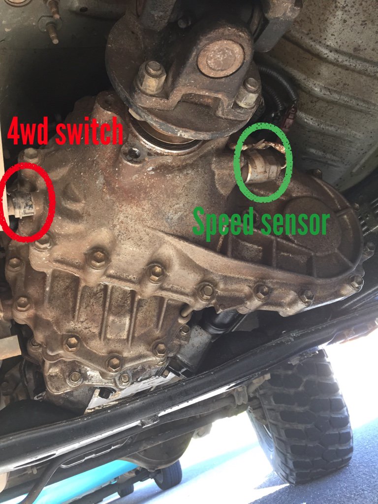

    This is the back of the transfer case looking forwards on my GU chief - check the 4wd switch
