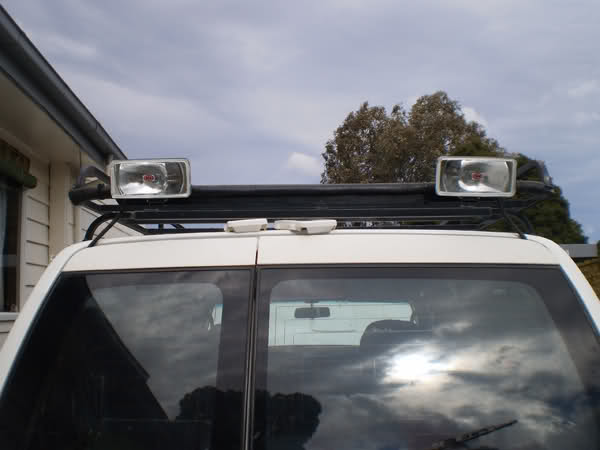

    Here's a short guide on how to wire some spotlights to the rear of your 4wd.
    I used a spotlight kit from Super Cheap Auto. It cost me $80 and it came with almost everything I needed. There wasn't enough cable or connectors for the wires so I bought 2 more reels of wire and an economy kit of wire connectors. You don't have to use 2 spotlights, in fact, 1 spreader light probably works better for reversing but I plan on adding a swivel joint to these lights so I can use them as work lights in the future.
    Here is the finished result in the day light. I drilled a couple of holes through the roof rack and the lights simply bolt through them. The only movement I have right now is up and down. Cables are run through 2 holes, 1 in each corner behind the barn doors. I popped the small plug out and drilled them bigger to fit the wires through. Ideally, you will want to buy some rubber grommets to put in the holes.

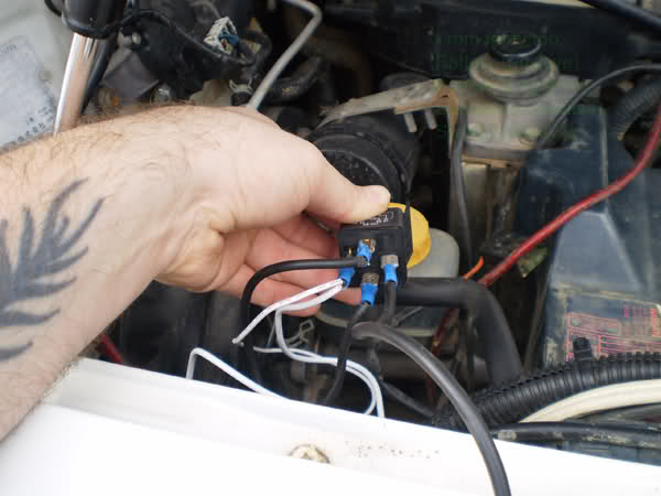

    This is the relay supplied with the lights. I'd never wired a relay before and I didn't realise the instructions were on the box. Once I read the diagram, it was straight forward.
    A brief description:
    White leads are the positive wires from the spotties.
    One black wire goes to the positive connection on the switch.
    One black lead goes to the positive terminal on the battery.
    One black lead goes to the negative terminal on the battery.
    One black lead also goes from the accessories connection on the switch, straight to the positive on the battery -it doesn't go through the relay. This is so I can switch the lights on and off whenever I like, rather than needing the high beams on like spotties fitted to the front.
    Self explanatory. These are the instructions from the kit. A brief run down for those not too great at reading diagrams.
    Spotlight negative wires go to an Earth.
    Spotlight positive wires go to the Relay.
    From the Relay, run a wire to Earth.
    From the Relay, run a wire to Switch.
    From the Relay, run a wire to positive battery.
    From the Battery, run a lead from negative terminal to car body. (already done)
    From the Switch, run a wire to a 12v source. (I went to the positive battery terminal)

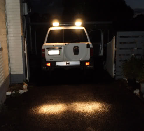

    Spot lights at night WITH a camera flash. You can see where the lights are angled. The flash also knocks out all of the "glow" from the spotties and it looks pretty crap.

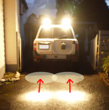

    No flash this time. There is still a definite spot light on the ground but also it lights up the entire rear of the car. I have angled my lights down to bring the spot lights on the ground closer to the car, as per pic above. The arrows represent where the light appears on the ground.

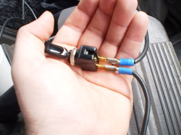

    The switch is located in one of the black buttons running down the armrest console on the passenger side. I have it so that DOWN is off and UP is on. I did this because I quite often throw my jacket or bag on the front seat and I didn't want it hitting the switch and turning the lights on, especially during the day when I wouldn't know.
    Lastly, I will be changing the switch to a smaller silver one. I will also make the lights swivel so they can point out to the side of the 4wd.
