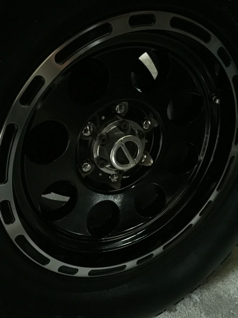

    Removed them, wire wheeled the crap and paint off them, then hit them with a buffing wheel and metal polish. Has come up alright.

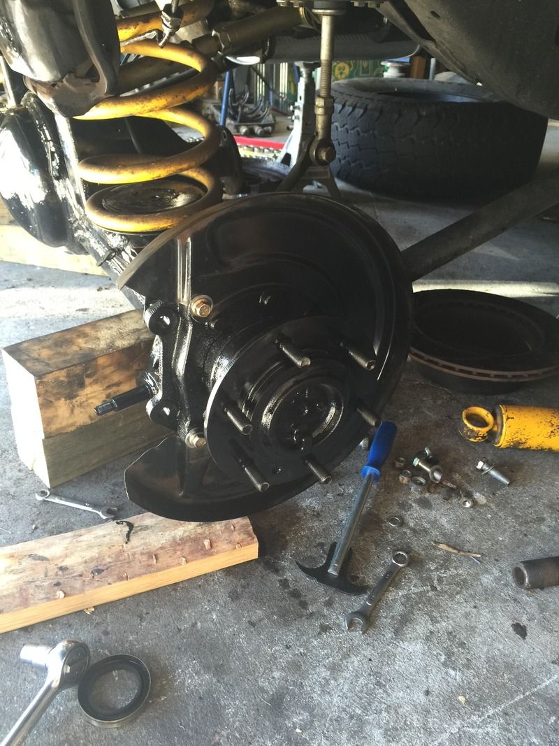

    The rear brakes that I rebuilt started leaking. Wasn't sure if it was the aftermarket seal kit I used or the fact that the calippers should probably have been chucked in the bin originally, so I bought a new set.
    All painted up, installed, bled and working perfectly.

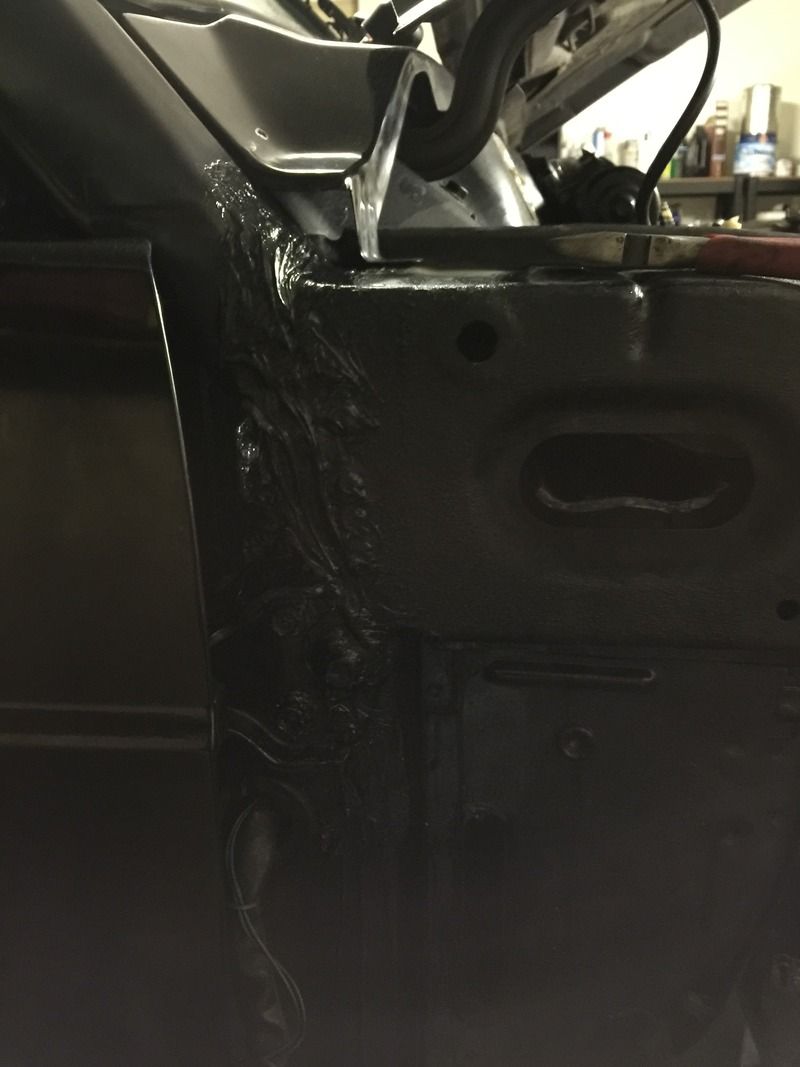

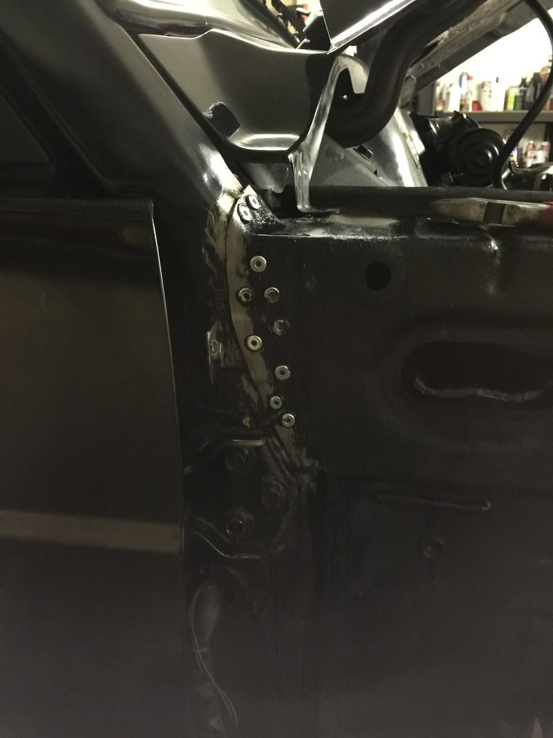

    I managed to sort out my drivers door rattle by adjusting the door hinges. Was very happy with this result, but realised I still had a strange noise when accelerating or braking. Thanks to Facebook, They pointed me towards the A pillar base where from factory, the spot welds they put on are insignificant and tend to break. So I cleaned it all up, riveted it all together with steel rivets and sealed it all up. Now it is solid as a rock. This can be felt from within the cab. Was a strange creeking noise that used to bug me a lot. But all good now.

    Garett, I couldn't physically see anything wrong. The only sign I had that the two panels were sliding against each other was a bit of corrosion between the two panels. I treated this by dripping metal resdy(phosphoric acid) down the seems and letting it work it's Magic. Then sealed it by dripping penetrol down the seems after. This stuff claims to soak into the metal and seal it completely.
    Driving to work this morning was a pleasure. I am winning the annoying rattles and squeezs battle.
