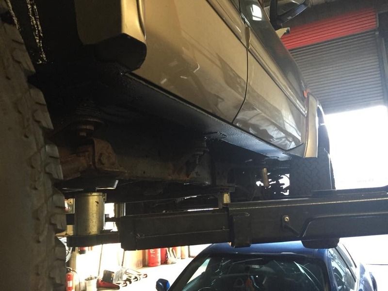

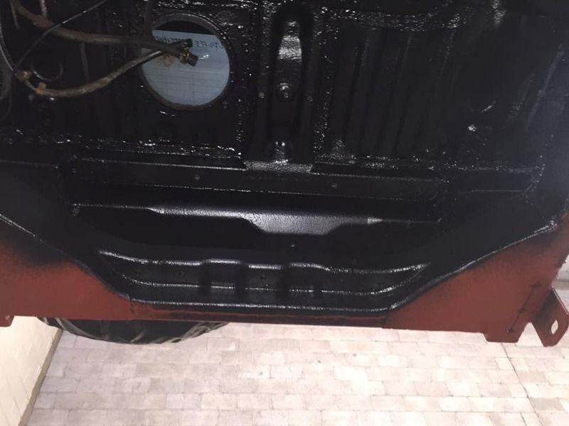

    surely that chassis is U/S ,but other than that the work done looks great
    Chassis looks worse in the photo mate, three small patches need sorting, crap chopped out heavy gauge steel seam welded in, be sorted.

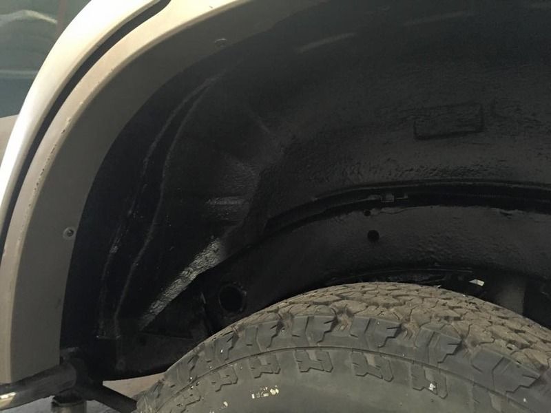

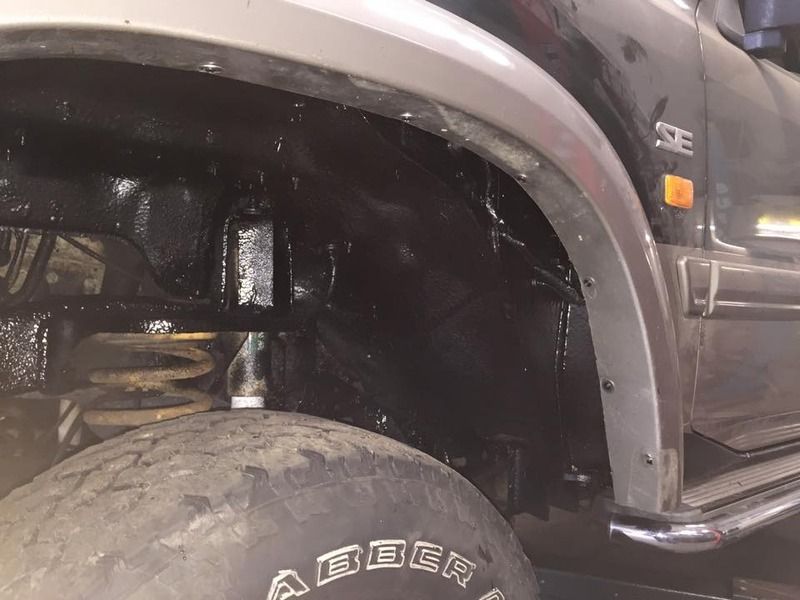

    Getting there now.

    Is that a pitch/tar spray on or brush on, looks the goods to sound deaden as well

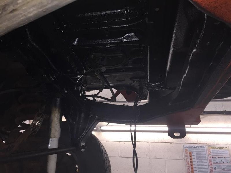

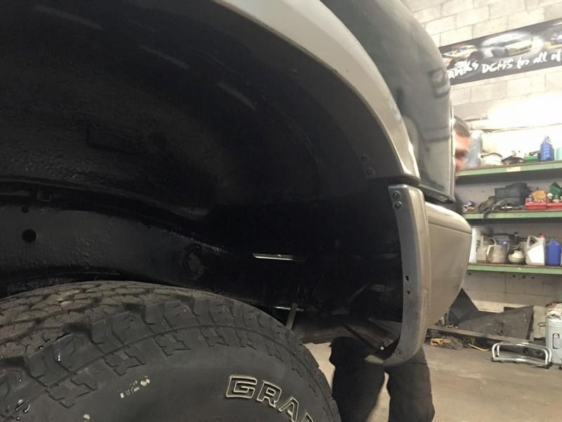

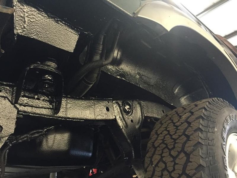

    It is schultz mate, spray on. Though I think you can get paint. It is high impact resistant and has rust inhibiter in it. The underside was sprayed with rust converter before the schultz was put on.
    http://www.frost.co.uk/schutz-underseal-1-litre.html
    I will spray it with waxoyl afterwards as well. Should not need welding again.
    http://www.amazon.co.uk/Hammerite-50.../dp/B001GU4DFQ

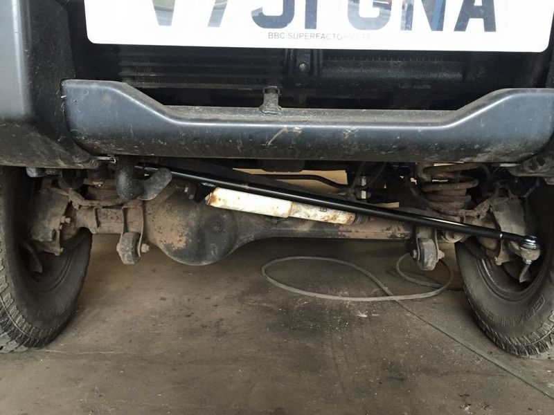

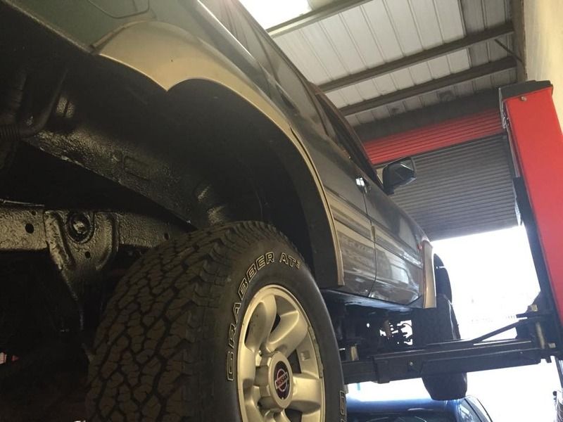

    All done, 2.5 inch exhaust right through( pulls and breathes far better now), new brake pipes throughout and a new steering tie rod.Will get better pics later.
    Gash rear light protecters have gone as well. Fuel gauge not working ,going back next weekend,should be something simple.

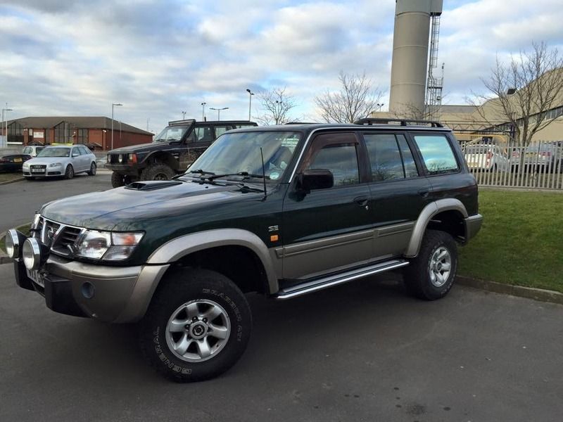

    I love that schutzs stuff, for the front diff a product called POR-15 is awesome
    mirror finish cant chip or scratch it. So itll be ready in time for the Ashes? ouch lol
    Are they OE mags or after market?
    those side steps are pretty slick to, UK after market too ??

    I have some of that POR 15 paint, may do the front diff with it, not sure yet mate.

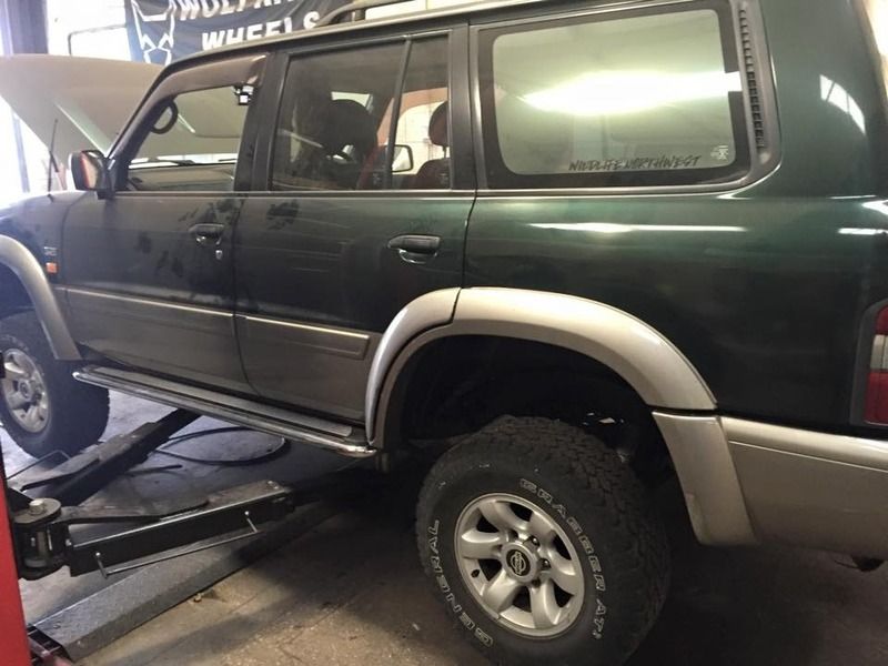

    OE Mags?...does that mean the alloy wheels, if so yes, standard 16 inch rims and the side steps were on it when I got it, not sure of origin. Mrs Frac is slightly disabled, so the steps had to stay.
    But she looks good now, the Patrol I mean, the wife is cool as well.....
