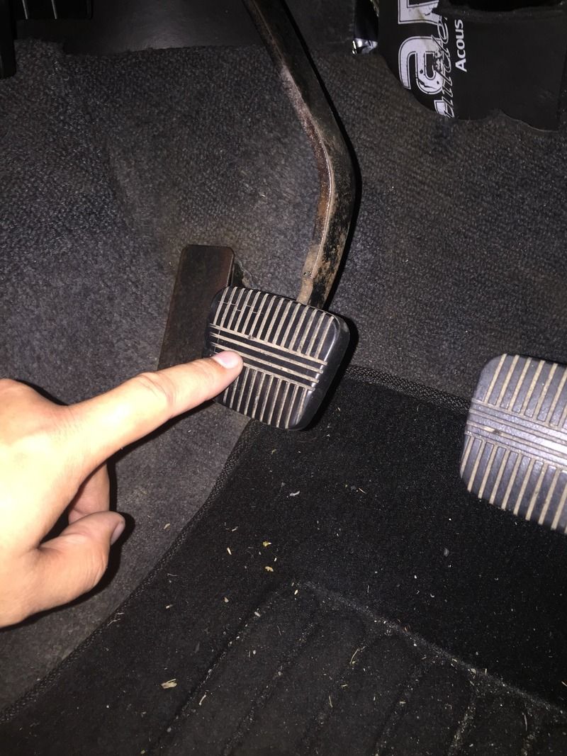

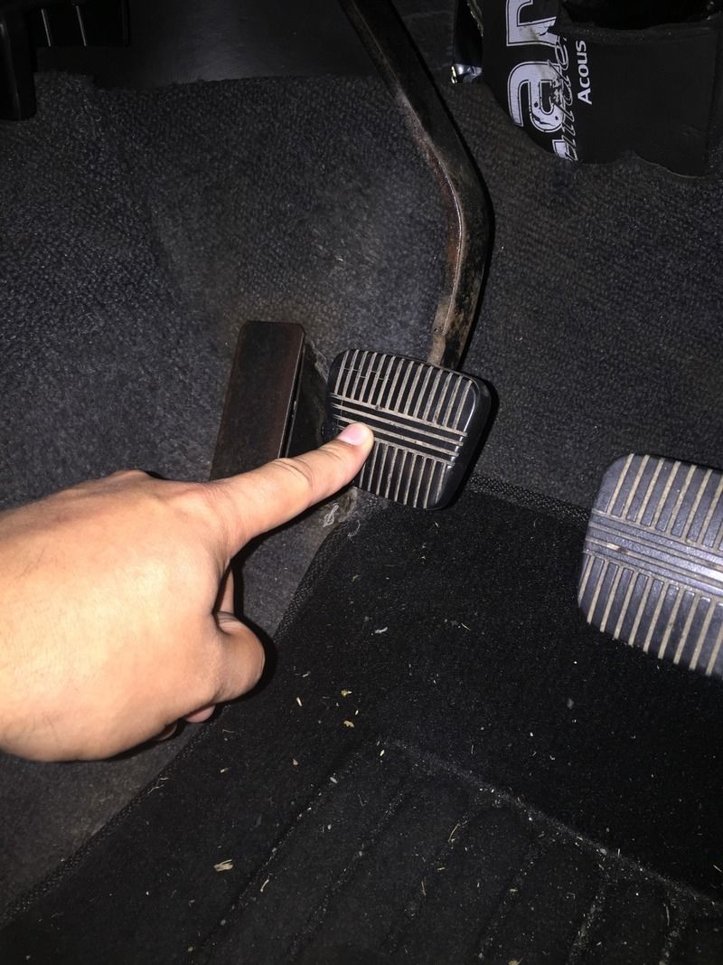

    Have you bled all the air out as there is a bleed nipple on the passenger side fire wall which caught me out. Also there's an adjustment on the pedal itself if you need to I think it's a 14 mm spanner
