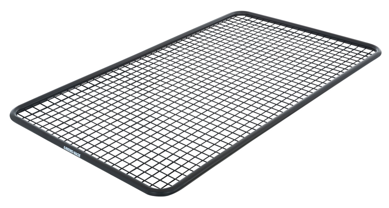

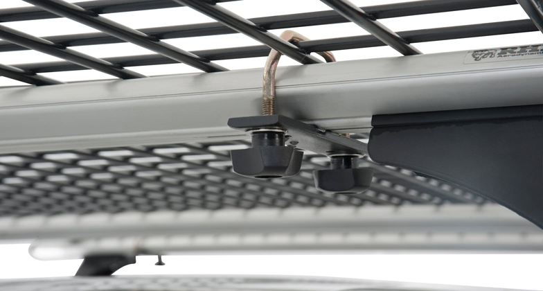

    Hey Rock Trol, just ti make sure that every one is on right page, this is what I think you have
    which is attached to your bars by these (or similar)
    Now I'm far from an expert in matters such as these but I don't think a wind deflector would make a difference.

    Thanks guys. I actually have moved the platform forward about 10 cm as well when I added the 2 extra bars. I think that gq_simon is on to something.
    And Clunk you are correct, it is the type of platform in your picture.
    Do you think having 5 bars would affect the harmonics?
    Maybe I should move the front bar back behind the drivers door or over B pillar and move the whole rack until it over hangs the rear (used to stick out the back previously).
