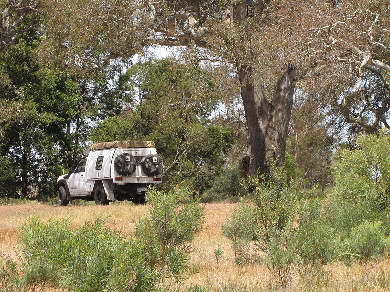

    Nipped over to Lake Burrumbeet this arvo, with the intention to do some walking. Did a bit, but then decided to drive the Patrol round the lake. Deep washouts & potholes saw me having to use low range. However what should have been fun was horrible. *Every* time even the slightest amount of flex occurred the most awful & loud squeaking happened. I had suspected it might, I’ve noticed it occasionally when mounting kerbs etc & thought it was my rubber mounting of the pod when the chassis rails flex a bit. The noise was bad enough to spoil any enjoyment there might have been.
    Got home & googled ‘4wd squeaks’ & found all references were to suspension. Went around the greasable shackles with the grease gun - have done this before, don’t forget *all* the suspension (springs - Leaf & coil, shocks & bushes) were new with the GVM upgrade, & not a heck of a lot of miles done since. Also liberally sprayed everywhere around springs & shocks with CRC - & then went for a drive through my local wood.
    Came home with a big smile on my dial, the track was tight between trees, with a few deep puddles, plenty of washouts, drops over tree roots etc etc ...... & not a single bloody squeak! It would be nice if it is greasing the shackles which has done the job, but if the squeaks return I at least now know that it’s suspension & not pod related. I know CRC is not the answer, but it’s good to know where the problem lays.
