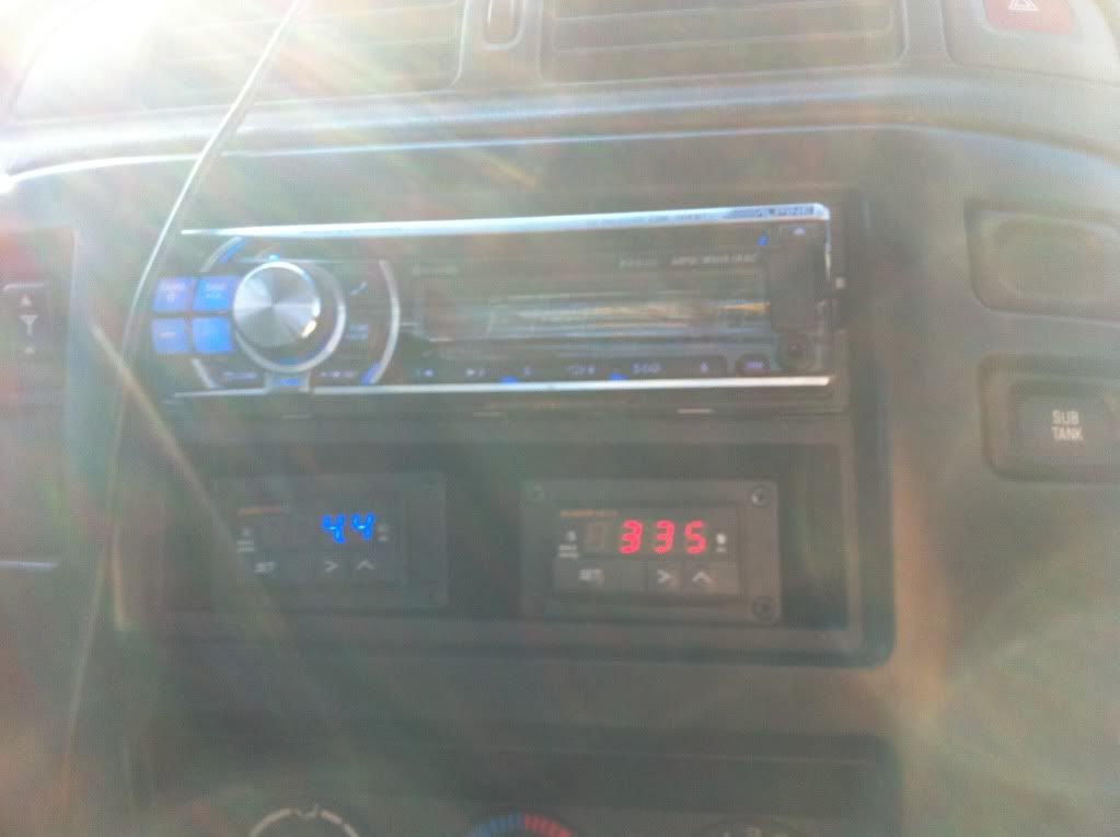

    Boost and pyro gauges installed, had the pyro in for a few weeks now and the boost showed up today. Turbotech controller installed and set to 13.5 psi
    Its bloody hard getting a decent pic while driving haha
