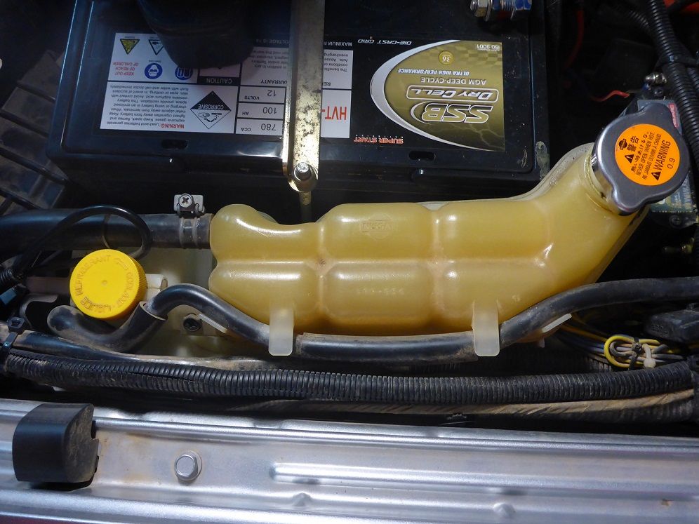

    Thats not actually the overflow. Its the reservoir. The overflow has a yellow cap on it. The opening snicko posted a pic of is like that on all gu with that setup. The reservoir will see cooling system pressure.
    Obviously being plastic they dont last forever and become brittle.
    So from there ( which is her Radiator cap yeah) a hose should go back to the yellow cap at the other end i can see in teh second last pic yeah? is that hose that is clipped into the top of teh reservoir that seems to go past then down, is that supposed to be going to that cap?
    Snicko is there a hose coming from the bottle with the Yellow cap to this bottle anywhere?
    The hose that goes to the overflow from the reservoir is in another location. That little spout looking think is just an over flow from the cap if the pressure is exceeded. It could be possible the hose between reservoir and overflow has a problem.

    in the second photo the liquid looks green in colour like coolant dripping from the bottom of the bump stop

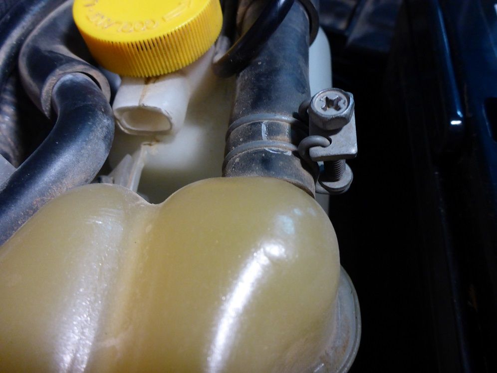

    Is this where the hose should be?

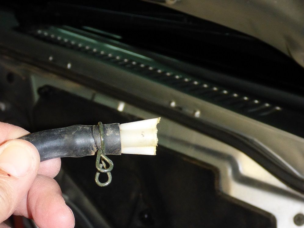

    The small hose which is clipped to the side of the reservoir where does this go? It looks as though the little tail that comes out the filler neck which the hose goes onto has broken off.

    Snicko in that top pic is that hose coming out of the top of the bottle with the yellow lid or from beside it? if it come out the top of that bottle where does the other end go? That is the hose that is clipped along the length of the reservoir bottle and then disappears near your catch can. where does that go?
    yeah thats what i was trying to say earlier, but i dont really know these bloody ZD30s and it looks a little different to mine.
    Look what I found
    I pull a few hoses and this one came up!!
    Thanks guys for helping me find the problem - much appreciated
