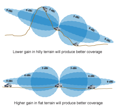

    Quote Originally Posted by Ronin View Post
    This pic should explain which antenna u should get. For Simpson desert I would say a high gain antenna.
    Depends what you call high gain.
    The Simpson is a significant amount of dune travel IE the vehicle is pointing at the moon or the dirt 50 metres in front therefore so is your antenna radiation lobe.
    I would def not recommend anything higher than 6 dBi and 4.5 dBi would be close to ideal
    8 or 9 dBi co-linears etc would be fairly problematic and cause comms issues unless you are both on top of a dune
