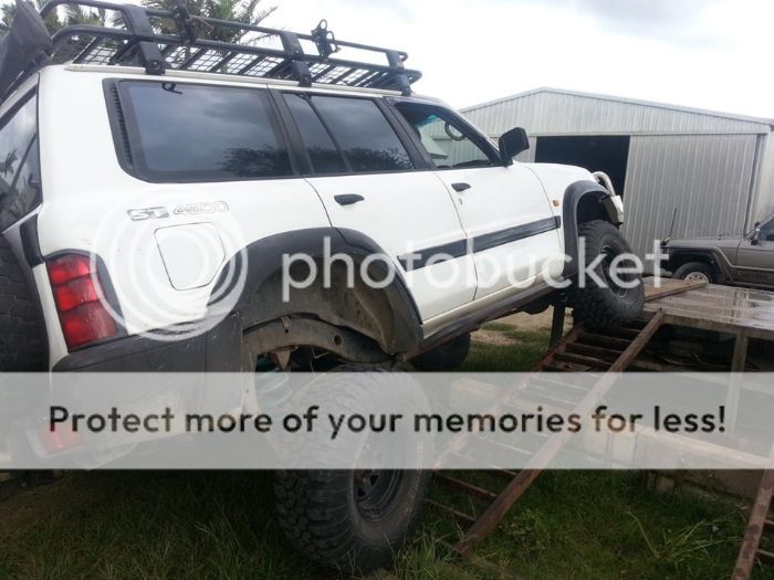

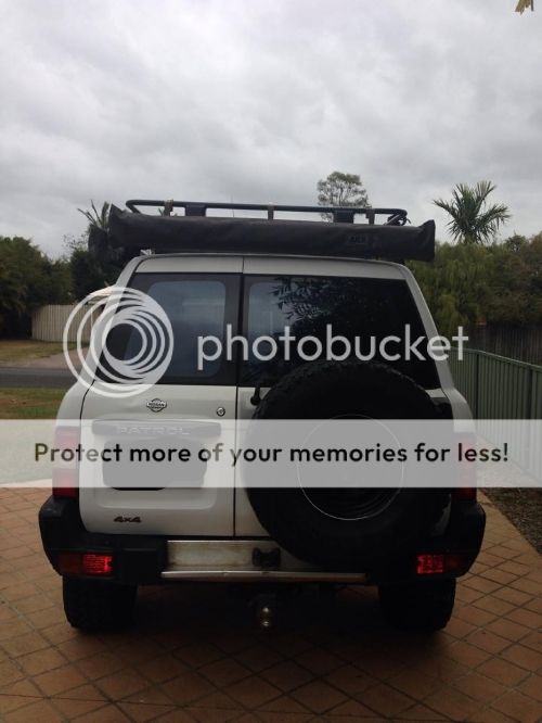

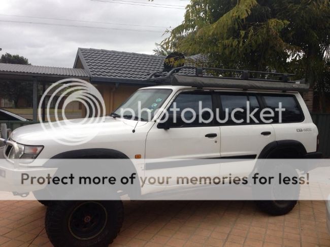

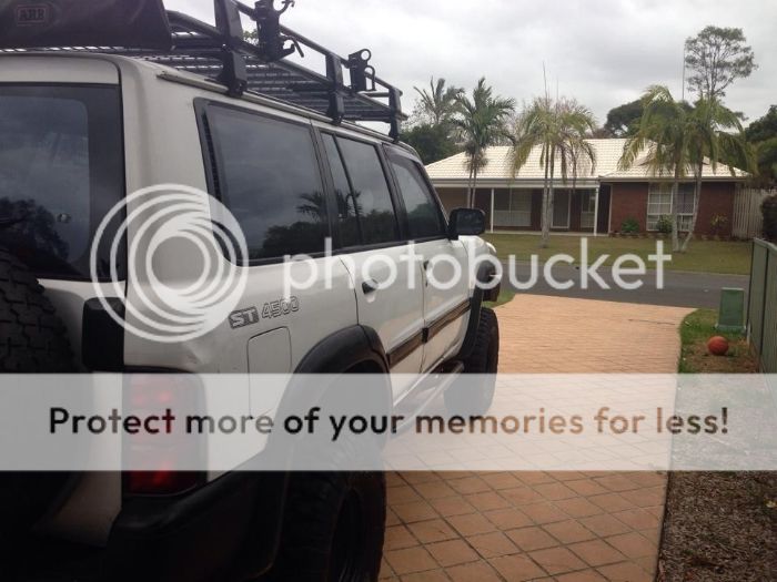

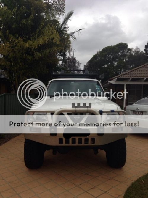

    Hi everybody! Thought i'd throw up a debrief on my 1998 4.5L petrol GU patrol I picked up a couple weekends ago. Picked up for a decently cheap price at a bit over 240000km on the clock. Pretty impressed so far but have also had to tinker with a few things to get it on the road.
    When i picked it up it was running:
    4" lift running Lovells springs, ProComp ES9000 shocks and a bit of superior engineering gear
    33x12.5 Maxxis Bighorns
    Bolt on rock sliders
    Full length ARB roofrack with shovel/hi lift jack holster
    ARB side and rear awnings
    Wiring for a auxiliary battery system in the rear
    UHF
    Goals will be to:
    Clean up my sliders (a little bit of surface rust condition, not very aesthetic at all) and possibly repaint my bar to black
    3" exhaust system
    4" stainless steel snorkel
    Pair of spotties for the bullbar (accepting recommendations ) and possibly 1 big or 2 small lightbars mounted to front of the roof rack
    Second battery to go into the existing dual system setup
    Rear bar + rear reverse/work light
    And finally just some general other cosmetic changes and recovery gear setup
    Full flex and tuck
    Cheers,
    Cameron

    G'day Cam, great looking rig.
    Looks like your GUrls had some Max's Muscle cos she loves to flex. Lol

    You're not wrong lol.
    Just need to sort out a power issue and she'll be a real monster.

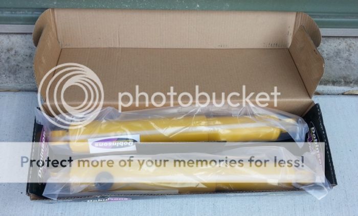

    Also had a chance to replace my ProComp ES9000 shocks that we're worn pretty bad in the rear, the front surprisingly not to bad at all but stuck in there like all hell.. Had the dreaded shock spinning situation when trying to lock it into place to ratchet off the bottom nut on both left and right hand sides. Ended up having to grind off the right hand shock just near the bottom of the chamber and was as simple as unbolting the top as per usual and banging the remaining bolt out at the bottom with a hammer.
    The left side a whole different story, PITA. Top bolt wouldn't budge either so ended up having to grind the piston halfway up, then remove the brace up the top and cut off piston again and pull the whole thing out that way.. what should have been a 30minute job turned into a couple hours and a heap of swearing at the blastard things.
    Old rear shocks and the bottom bush from the left rear: (didnt bother with front shock pictures, got binned instantly out of spite)
    And the new 4" dobinson I ordered from Superior to go in:
    Just replacing the shocks has made great improvements, rides alot more smoother and the body roll around corners has easily more than halved what it was prior. Overall am happy with this mod
