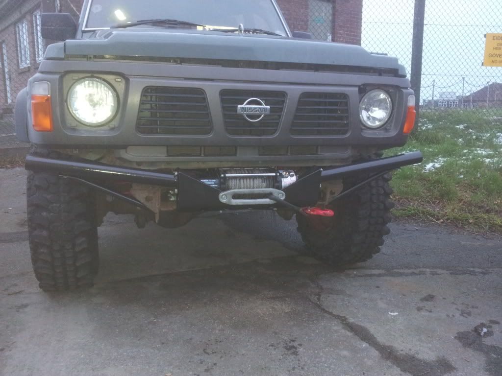

    I've removed the old brake bias adjuster off the back axle as it was goosed . Replacement cost over here was over 400 UK imperial Pounds I fitted a simple manual brake bias adjuster lever and replumbed the back end accordingly. This truck has no seats in the back and spends most of it's driving offroad. I find it works a treat and passed our UK road worthiness test with no problems.
    Next on my list was to make up a front "Bar" of my own design (mainly) again out of necessity as pre made ones here are flippin' expensive
    So I sketched out what I wanted and set about making a mock up.
    Used some old ply and rain water pipe to get templates from.
    It's basically a winch tray and then some bar bolted on. It will eventually be added to as I'm making an exo cage for it soon.
    And with the winch in place
    Finally with some hammerite on it
    Currently working on the wiring options for me to switch it internally and externally from both wander lead and remote
    Coming up next :- internal snorkel, you have been warned lol
