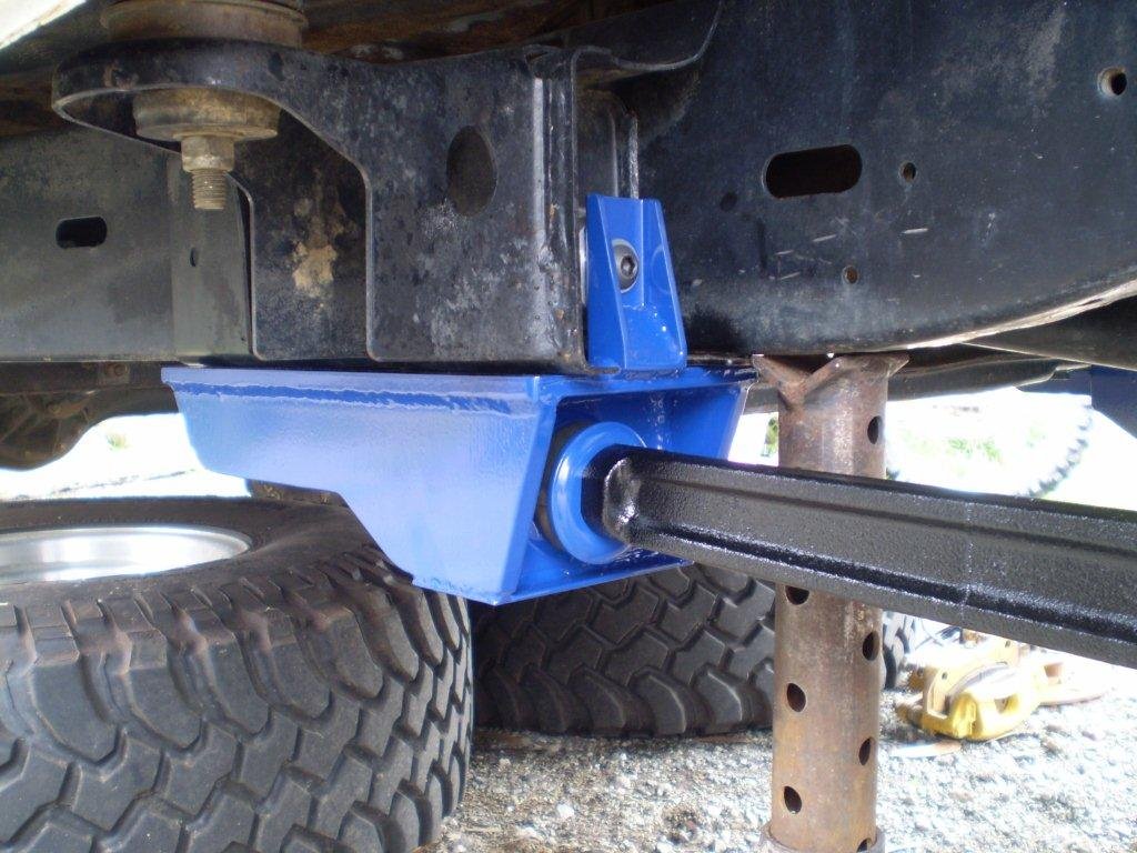

    So 100mm longer do you need to extend the front driveshaft or is this distance gain at the chassis end.
  2. #902
    15,485
    12,379
    334 Post(s)
    Quote Originally Posted by megatexture View Post
    yes it is at the chassis end Mega.
    If you have a look at this pic and note that the top mount is in line with the factory mount (in fact it connects to this position for strength) and the bottom mount is set 100mm back.
    and here is a standard Superior Drop Box. the top mount is consistent between the two pics

    Isnt that last pic standard arms with a drop box

    yes. It was the best pic i could find showing the standard drop box location position for the rear joint of the radius arm. you can see that a standard drop box just drops the pivot only inline with the factory setup. the Hybrid that Bene has sorted pushes that back 100mm below the gearbox support.
