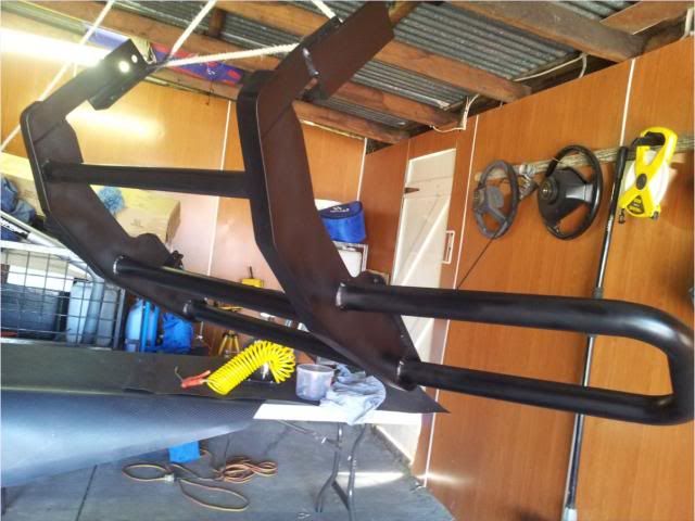

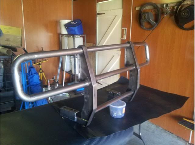

    1. Preparation is the most important . Sand using higher grit sandpaper to make it smooth as possible , Use wax and grease remover to clean the bar as thorough as possible.
    I sanded mine back to bare metal.

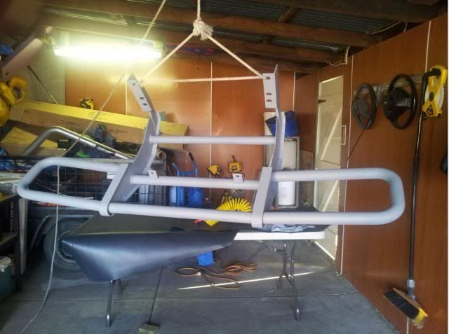

    2. If you can hang the bulbar up with some rope would be good. Makes painting and drying easier.
    Paint on the spray can primer . Once covered let it dry for recommended time . Then use a new can to do a second coat . then let it dry fully . You can rub back the primer lightly if you wish to smooth out.

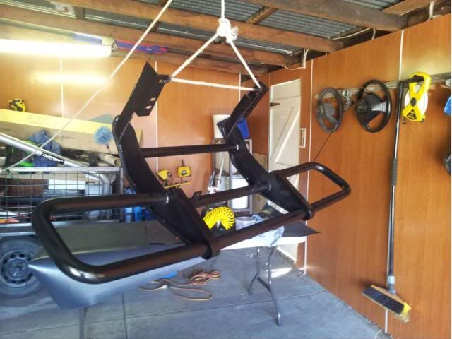

    3. The primer has dried for a few days ready to paint. make sure its clean and dust free surface on the bulbar . You can now paint on the SATIN black . Make sure you use even strokes, don't worry if its not perfect for first coat .
    4. After you first coat , you can do your second coat as final . up to you how many coats. but make sure it dries for a few days before putting on another full coat. After final coat has been applied. I let it dry for about a week before putting it back on.

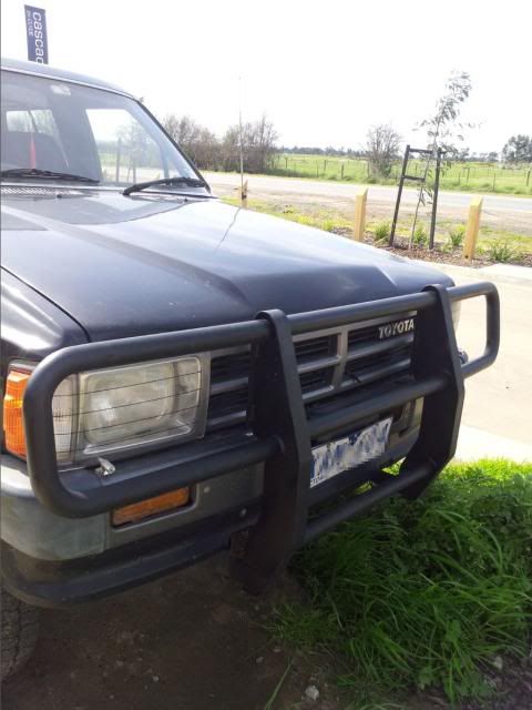

    5. This is how it looks 2 years later . No chips or marks . Bit dirty though
