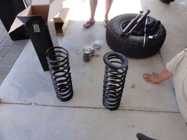

    Some of the bits from the Suspension Stuff Flexi kit. Coils, coil rubbers, ext. rear bumpstops, f + R shocks etc... Rear tail-shaft has also been flipped 180 degs so that it doesn't hit on the crossmember on full droop. Brake bias bracket was also installed.
    Yeah that's Stropp's feet
    Finished product.

    nice feet bloggsy, also some nice bits there, might have to get richard to have another bits day so i can put bigger springs in the back of mine and brake lines etc BTW lookin good mate.

    what size flexi coils are you running ?

    Thanks mate, they are 3"
