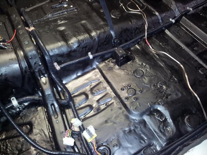

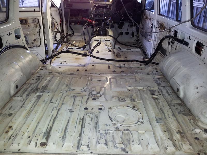

    I've been quite last few days this is why. I still have a mountain of work ahead to conduct separate everything.

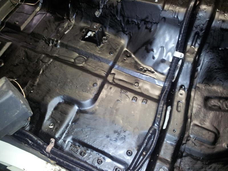

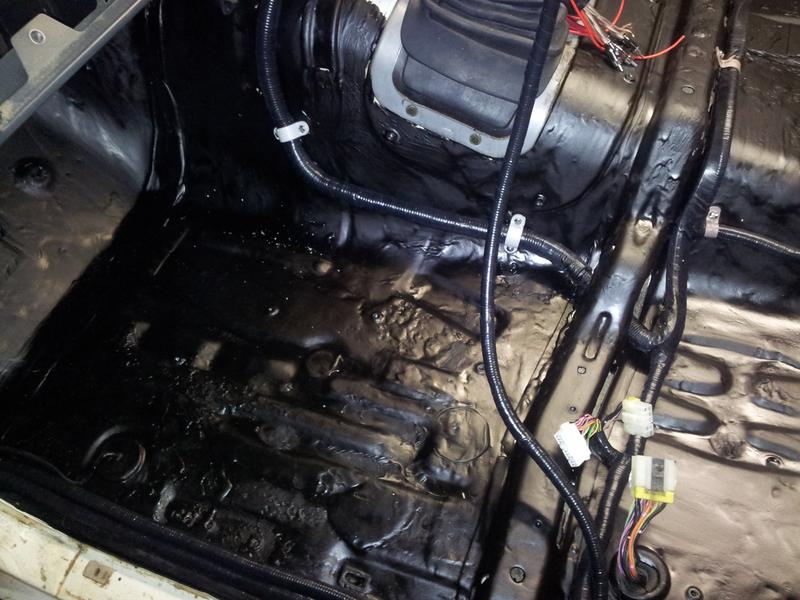

    While its apart like that mate go and buy a 4lt tin of brush on Sound deadener and give the floor 3 or 4 coats and also the inside of the door skins. You will thank yourself.
  4. #3
    15,484
    12,378
    334 Post(s)

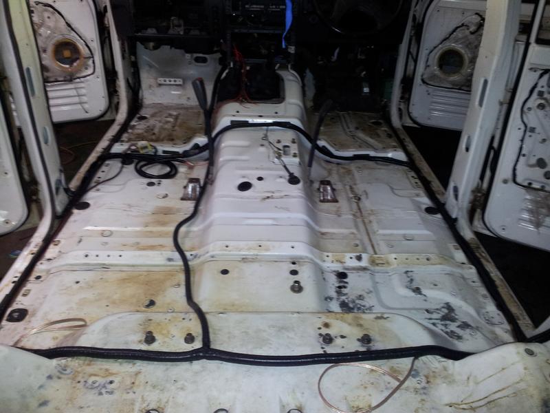

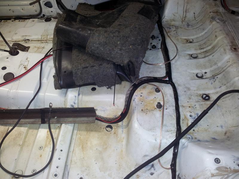

    Also think about buying a heap of different coloured heat shrink and colour code both ends of everything so you don't have to rely on labels that might not be readable in 5 years. A band of heat shrink 40mm long on both ends of each wire or a few wraps of electrical tape on each end will be a winner mate.
    Just trying to help
    Good on ya mate. Enjoy.

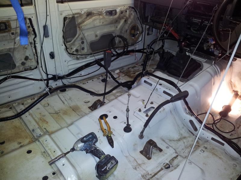

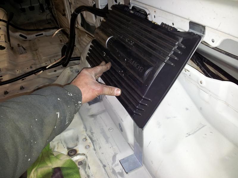

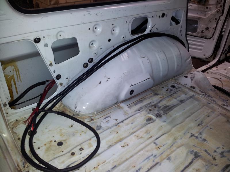

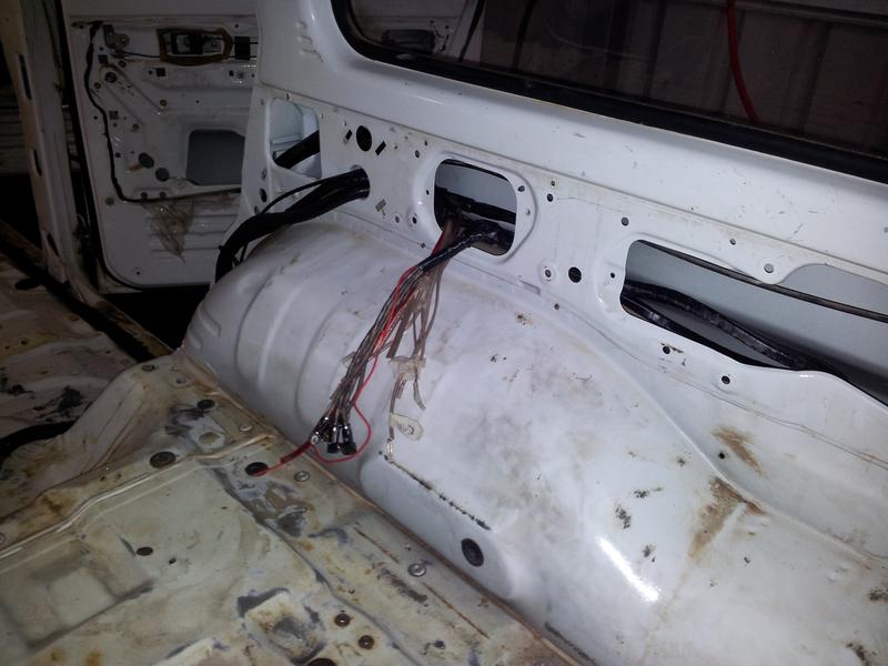

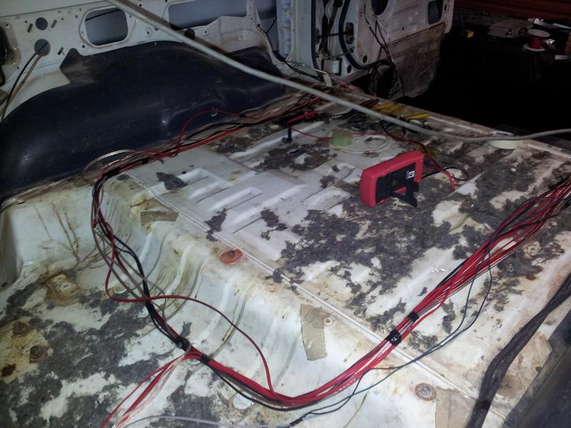

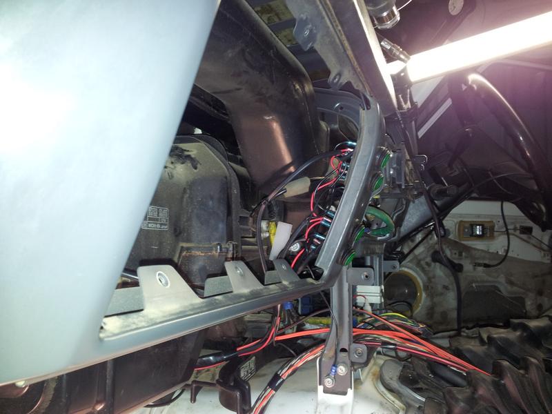

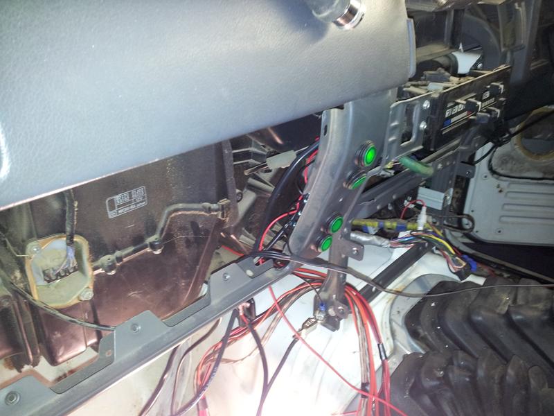

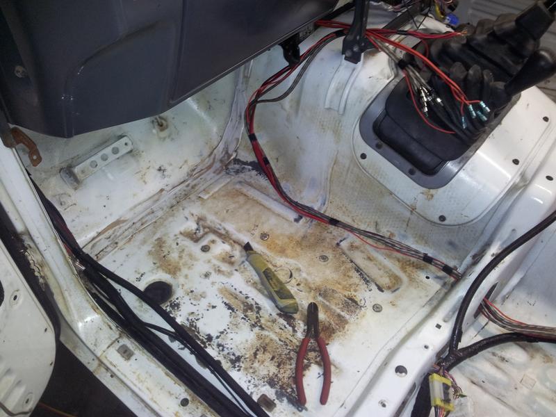

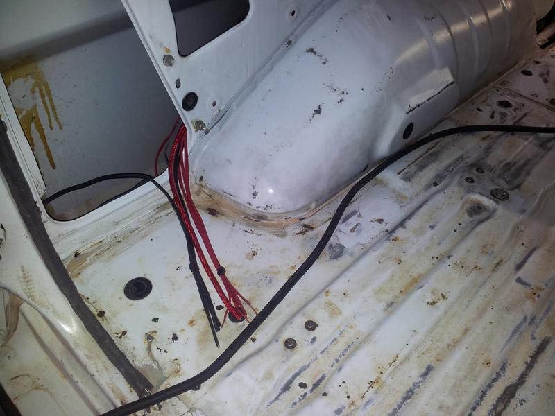

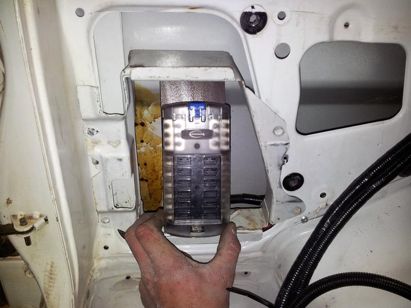

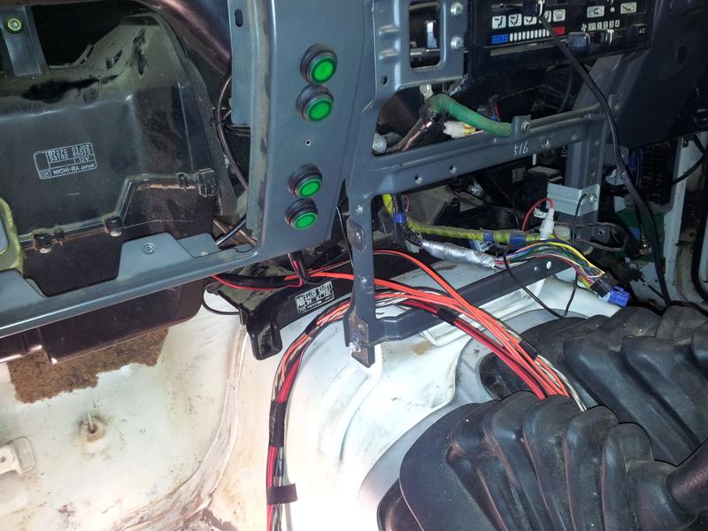

    Cheers mate, I've allowed cable for everything. I know it looks like a mess atm .
    Central locking,
    Amps
    Sub
    6x9's
    fridges
    12volt sockets
    worklights 4 allowed for rear.
    4 switches back to cabin.
    I would hate to think how much money I've spent on cable not to mention switches/relays/fuses boxes so on so forth.

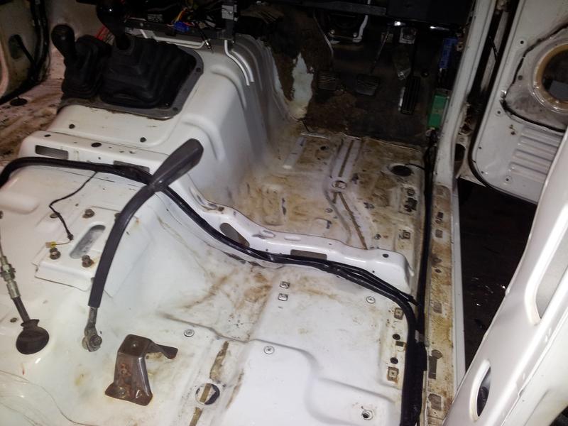

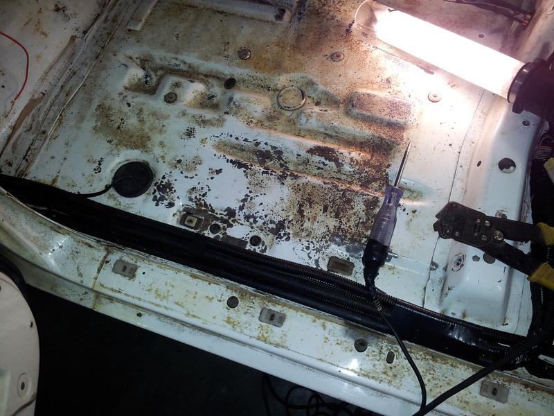

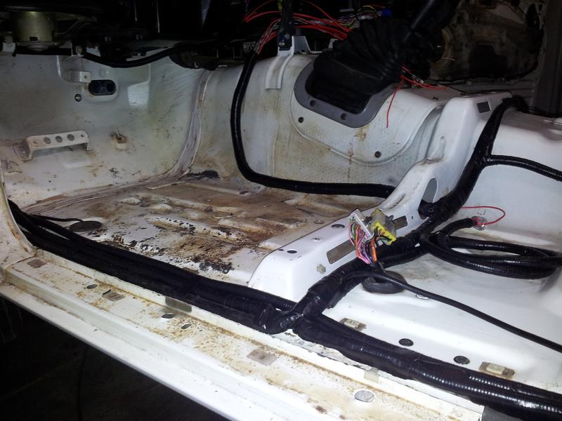

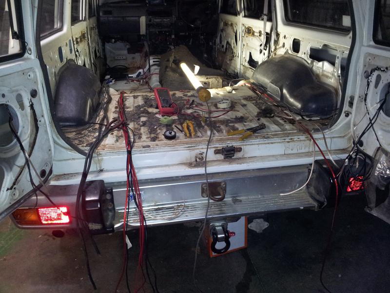

    Probably up to about 40-50 hours, coming together tho. Rear seats wont be going back in, full length draws with a cargo barrier. Seal and sound proof the floor .

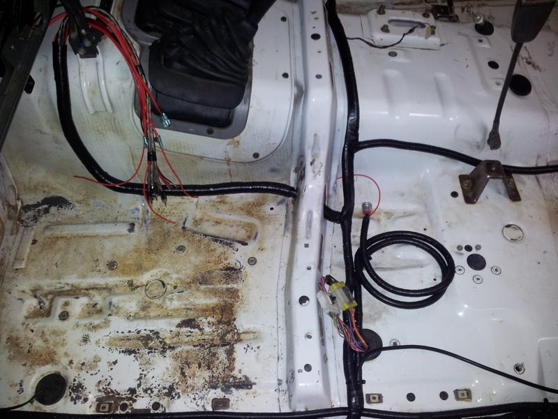

    Takes lot of time but it was worth it.
