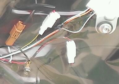

    OK folks, problem fixed!!!
    Large rear, panel off, pair of wires going down to the bottom latch point, where the trigger switch seems to be. I messed around trying to fix so the switch initiates when door shuts, but in the end I just disconnected it as per the photo. Problem fixed!!

    Great stuff, I had the trim off my door on Sunday to adjust the hinge and snapped a shot of the same plug for you. The switch appears to be in the latch. Can,t see that disconnecting it would be a prob, the little door switch is going to tell you if either are open.

    Many thanks for that. Yeh I had enough this morning and just went for it, so nice to jump in the car tonight and the light turns on when you open the door, and off when you shut it. Haven't had this function since buying this GU. lol
