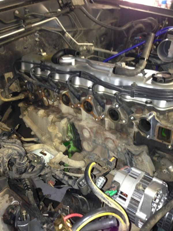

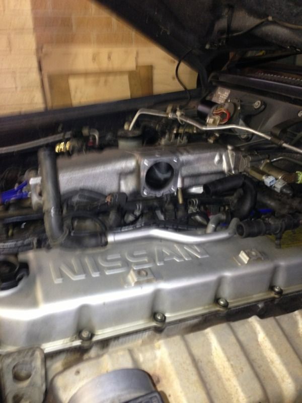

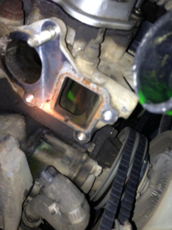

    Hi all, if anyone is interested, I'll post pictures of my efforts. Ended up pulling off the intake and replacing the gasket and also the collector gasket. Horrible, horrible job, but the engine runs super smooth. So much infact that at idle I barely hear it running. No more puff, puff sounds at the exhaust anymore. Vacuum leak sorted. Even engine temps are lower. Everything has vastly improved. Very happy with the end result. If anyone needs some pointers, just ask.
