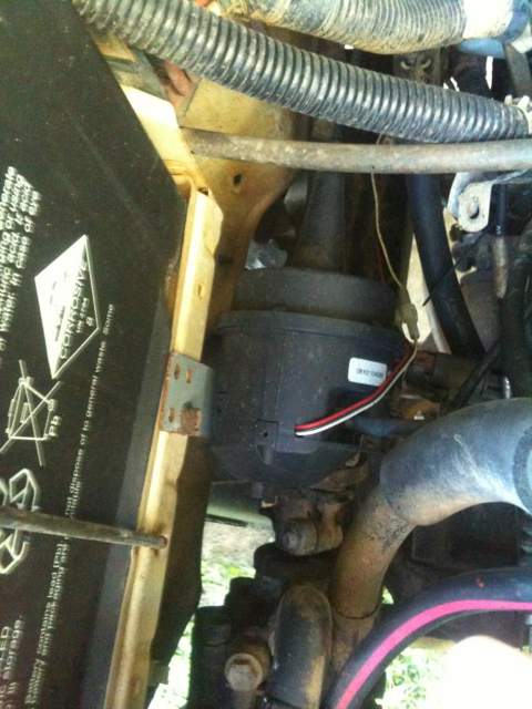

    Is the cable able to be cut to length? Is prefer to mount it close as possible or the engine bay will become a bird's nest..

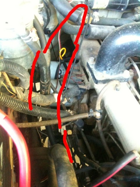

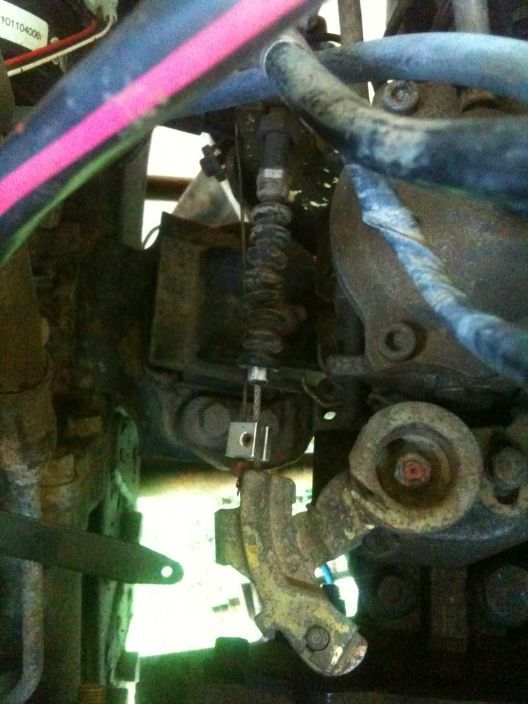

    The cable has one of those cylinder things on the end but I guess you could cut it and fit some kind of crimp or screw lug on the end. Here are some pics of mine.
    Actuator mounting
    The red line shows the route of the actuator cable.
    The cable mounts to the throttle cable with this little silver clamp.

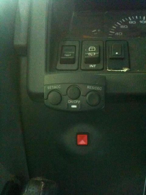

    Where I mounted the controller.

    Easy as. Yea that's easy to modify. A simple loop and crimp on the end and all will be good. Thanks for the pics.
    Does the led on the control panel change colour or something to show if engaged or not?

    Nah, the led just turns on (red) when you turn the unit on.
