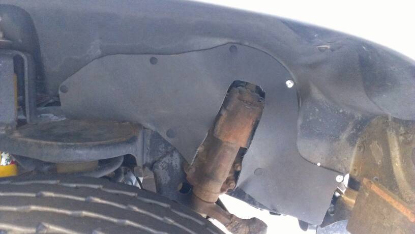

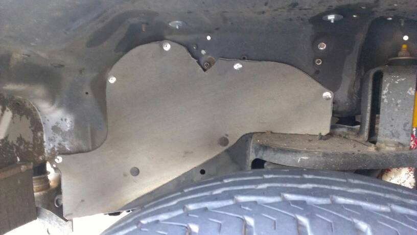

    Ok, from experience with mine running a 2" suspension and 1" body
    Remove bottom section of radiator fan shroud. It clips on and off, this gives the fan the clearance needed.. (your already running a 2" body so should be fine..)
    Brake lines yes, they connect from axle to body so need to be done. To be safe..
    Also a 4" brake bias bracket to correct that..
    As your already running a 2" body lift the main brake line from master cylinder to chassis is already modded.. and you should have already fixed the low range stick clearance issues.
    I made some fill in panels to suit the new lift, it greatly assisted in engine heat reduction. Just used old conveyor belt..
    So really, springs, shocks, castor correction if you like, brake lines, you should be good to go.
    No need to do any rods as they are all with in the limits of adjustment. If money burns a hole in your pocket, go for it.. but not needed..
    When I pull mine off the road I will be fitting up some engine block spacers to lift it back into the right position. This will assist in the low rage stick issues and remove the need for gear box drop spacers.
