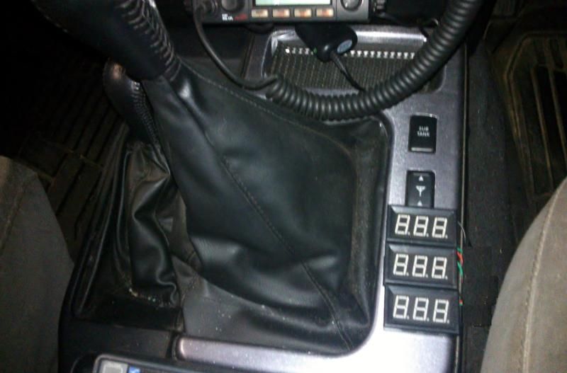

    Well my reasoning for the back would be because while camping I would be in and out of the back more.
    If you were parked up for a few days camping, how often would you go to the front compared to the back?
    Maybe the one for starter would be more appropriate up the front but definitely the other 2 up the back
    That's what I have done. I have one meter at the front for my start battery and one in the back for my aux battery. That way I can check my aux voltage every time I get a beer. So every 5mins

    Why not one up front, one in the rear, both with a 3 way switch

    Could do that but already has the 3 readouts anyway

    Quote Originally Posted by 04OFF View Post
    Id go one up front like cuppa, but put it on a 3 way switch so you can select what battery it displays, then put the other 2 gauges in the back !
    My gauge in the front is in addition to the battery monitor I have in the rear, it's my 'reminder' to ensure I don't forget to disconnect the aux batteries & start battery if I've used the winch. I don't have a gauge just for my start battery, your post has been useful, putting in a switch so I can check the crank battery voltage sounds like a good idea.
    Just keep one as a spare

    Finally did this using double sided tape. See how it goes for the time being, will think about other options for permanent fitting later. I'm keen to see the volts whilst charging, and can check easily enough when stationary.

    What about above the rearview mirror....I need to get a pic of mine to show you.

    Mate, what is the 3rd wire connected to?

    Quote Originally Posted by NP99 View Post
    Red is +, black is - and green is the + of the battery you want to monitor. At the moment all the reds and blacks are on a cigarette lighter plug that goes into the dash, also 1 of the greens is connected to the reds so it reads the "car" battery volts, of the other 2 greens one is run to the aux battery under the bonnet and one to the 3rd battery in the back.
