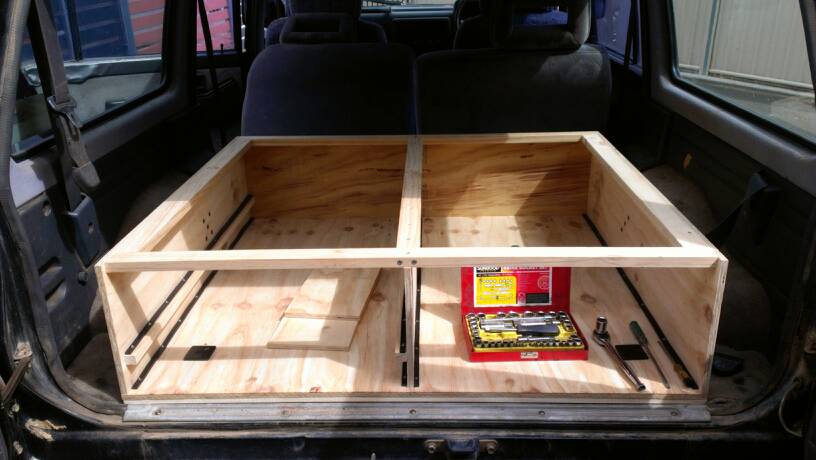

    Mid way threw mine.
    Fridge will sit on top left, above a short draw for recovery gear and under that will be a pull out bench top / table, the on the right is the full depth food and groceries draw.

    Quote Originally Posted by Westy's Accessories View Post
    Mid way threw mine.
    Owner of
    Westy's Accessories
    Looks good mate are you using slides or bearings?

    I'm gonna do a similar table slide but thinking aluminum u channel and slide a piece of ply into that.

    A very hard wearing nylon called UHMW..
    A 3mm thick bit on both sides and it slides like its in ice...

    That uhmw strip looks good westy. Where would I source that?

    Pretty sure the father in-law got it from banner (good hardware store). Comes in a rod form to. Cut it with a jig saw or band saw.
