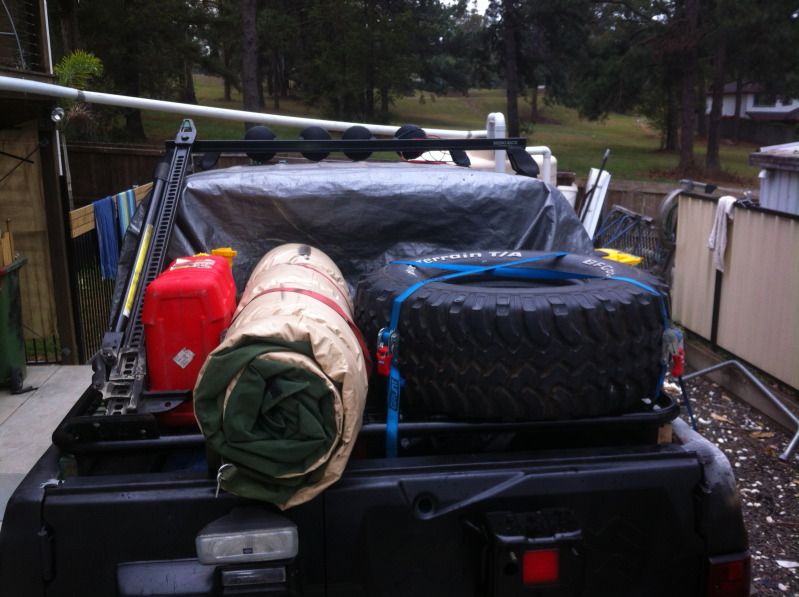

    Aren't the platform legs and the legs on my Rhino bars one in the same?
    Think you just attach the platform directly to your existing bars
    The legs are the same but different bars are used. Six legs per platform (8 can be fitted). I've moved the platform forward and added a single HD bar, so more storage with rtt fitted. I had to add 10mm spacers to the bar so everything was lined up. The GU has a slightly curved gutter toward the front and a couple of spaces on the front legs are also needed.
    Better than a thousand words.
