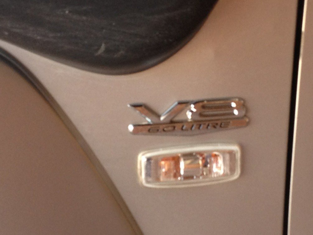

    I also decided that all the badges I put on look crap so I removed them all and replaced with these
    Sent while temporally motionless

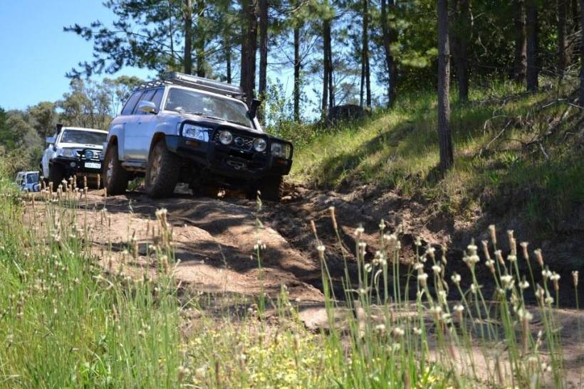

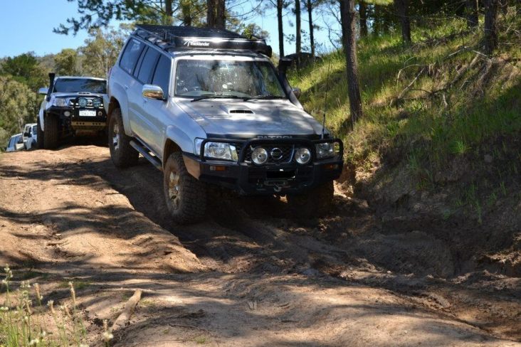

    A few pics from her first trip off road since the conversion
